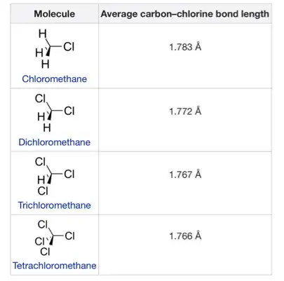

Consider carbon tetrachloride and chloromethane.
Obviously, carbon tetrachloride has the stronger and shorter carbon-halide bond because in chloromethane, the methyl group is slightly electron donating, and this repels the terminal chlorine, which lengthens the carbon-halide bond. No application of Bent's rule is necessary.
Sure, you can justify this difference with Bent's rule; s-character is concentrated in orbitals directed toward more electropositive substituents; the carbon is more electropositive than chlorine; thus, the bond has more s-character around the chlorine and more p-character around the carbon in chloromethane. This greater p-character around the carbon in chloromethane weakens the carbon-halide bond relative to the bond in carbon tetrachloride. And greater p-character in a bond is also correlated with a compression in bond angles.
However, bond angles are also explained nicely through Coulombic effects. The C-H bonds in chloromethane are obviously shorter due to the electron-withdrawing nature of chlorine and the carbon-chlorine bond is obviously expanded due to methyl group/chlorine lone pair repulsion. This shortening of the C-H bond lengths explains the H-C-H bond angle expansion in chloromethane, and the lengthening of the C-X bond explains the X-C-H bond angle expansion.
Is there any case in which other elementary considerations (Coulombic, VSEPR, van der Waals repulsions) fall short in the realm of molecular geometry and Bent's rule can step in to pick up the slack? Anyone got some sort of vindication for Bent's rule?

    You write 1) "the methyl group is slightly electron donating, and this repels the terminal chlorine, which lengthens the carbon-halide bond" and 2) "the carbon-chlorine bond is obviously expanded again due to the electron-withdrawing nature of chlorine" Are you saying that both electron donation and electron withdrawal increase bond length? – ron Aug 28 '14 at 22:46
  • Why should the [chlorine lone pair] - [C-Cl bonding electrons] repulsion in $\ce{CH3Cl}$ be different from that in $\ce{CH2Cl2}$ or $\ce{CCl4}$? – ron Aug 28 '14 at 22:58
  • In CCl4 the other chlorines isolate electron density from the carbon but in H3CCl the carbon pulls electron density from the hydrogens and the carbon therefore repels the chlorine more – Dissenter Aug 28 '14 at 22:59
    I read Bent's rule as, considering the hybrid orbitals around C, the ones directed toward electropositive substituents (e.g. H) have more s-character and the ones directed toward electronegative substituents have more p-character. I don't know what this statement means: "This greater p-character around the carbon in chloromethane weakens the carbon-halide bond relative to the bond in carbon tetrachloride." As I understand it, C has a certain amount of p-character (i.e. 3x 2p orbitals). How it uses those p-orbitals (invoking hybrids or not) may change depending on the substituents. – jerepierre Aug 29 '14 at 04:04
  • Right...p character in the c-cl bond – Dissenter Aug 29 '14 at 04:07
  • I think it would be helpful for this discussion to have a table of the actual data that we're trying to explain, perhaps all of the one carbon compounds starting with methane and replacing the H's with Cl's. – jerepierre Aug 29 '14 at 04:14

  • @martin are there any examples in which bents rule works while other guidelines fail? – Dissenter Aug 29 '14 at 12:25
    @Philipp, I think it might just be an issue of semantics. What I mean to say is that "orbitals" in the most formal sense are not distinct physical entities but a mathematical description, with the "observable" that can be experimentally probed being the electron density itself. – Greg E. Aug 29 '14 at 13:36
  • @Philipp, however, your point about PES is well taken. If I understand correctly, Koopmans' theorem relates the first ionization energy to the HOMO and the electron affinity to the LUMO, and in those instances the entire molecule is being probed indirectly. In that sense, I recognize that limiting the observables to the electron density alone is perhaps narrow. (I'm certainly no expert here, so please do correct me if I'm in error, and thank you for the thought-provoking comment.) – Greg E. Aug 29 '14 at 13:41
    @Dissenter Yes, many, almost all. For example, coulombic considerations in the series $\ce{H_{$4-n$}CF_{$n$}}$ would predict longer $\ce{C-F}$ bond lengths with increasing $n$ (repulsion of the negatively charged fluorine atoms), where the opposite is the case. In all other cases you can expect that Bent's rule is correct for the correct reasons, while other, simplified models are heavily relying on error compensation, e.g. VSEPR, therefore being correct accidentally. – Martin - マーチン Sep 01 '14 at 10:47
