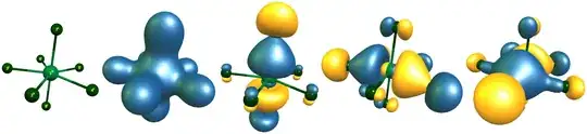

There are a total of four orbitals with contributions from iodine and fluorine. There are not more than eight bonding electrons. I cannot imagine that Christe et. al. found a different solution, as his level of theory was not better (maybe worse). They either did not know how to interpret these results or simply overlooked it. Here are the relevant lines from the output.
 Alpha occ 17 OE=-1.196 is I1-s=0.23 F7-s=0.18 F8-s=0.18
 Alpha occ 25 OE=-0.587 is I1-p=0.30 F7-p=0.28 F8-p=0.28
 Alpha occ 26 OE=-0.568 is I1-p=0.31 F4-p=0.19 F3-p=0.19
 Alpha occ 27 OE=-0.568 is I1-p=0.31 F2-p=0.21 F6-p=0.14 F5-p=0.14
(OE is the orbital eigenvalue in Hartree, the contributions missing from 1.00 are at the other atoms, but to small to trigger printing.)
bonding orbitals of IF7
In the LCAO bonding picture we have a totally symmetric bonding orbital from all atoms, an orbital referring to the axial bonds, and two degenerate orbitals for the equatorial plane.
