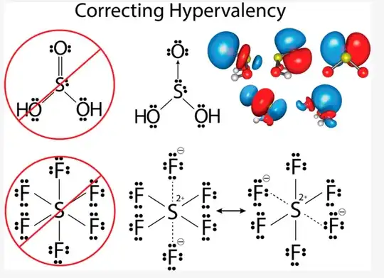

The logic is that if the only atomic orbitals on the central atoms you consider for bonding are s-orbitals and p-orbitals, you can't make more than 4 bonds (this also goes for sulfate and phosphate). If you want to stay close to Lewis structures, with a line representing two electrons, you have to invoke ionic bonds and resonance. For $\ce{SF6}$, you write $\ce{SF4^2+ + 2F-}$. This gives
enter image description here Source: Wikimedia via Wikipedia article on hypervalent molecule
The bonds are a combination of a covalent bond (bond order 2/3) and an ionic bond (attraction of 1/3 charge on fluoride with +2 charge on sulfur).
If you want to use MO-theory, you match the fluoride p-orbitals (the s-electrons don't participate) with the symmetry of the central atom's s-orbitals and p-orbitals (see illustration in the question). The four lowest combinations are shown below. If you use subtraction instead of addition, you get anti-bonding MOs (with more nodes; just like we learn for atomic orbitals, more nodes mean higher energy of electrons in that state).
These get filled with the 8 electrons available. 8 electrons would make 4 standard localized bonds, but here you connect 6 ligands, so the bond order is 4/6 = 2/3). This matches the bond order of 2/3 for the VB model above (localized bonds plus ionic interaction).
If you compare the S-F single bond lengths in other molecules to the bond length in $\ce{SF6}$, they are all very similar, even though e.g. the bonds in $\ce{SF2}$ are "real" single bonds and we just said the bonds in $\ce{SF6}$ have a bond order of 2/3. This is rationalized by the partially ionic character of the latter.
The $\ce{PCl5}$ molecule can be explained in a similar manner. The bond order is 4/5.
[Oscar Lanzi in comments] PCl5: bond orders may be different for equatorial and axial atoms, I would use 1 and 1/2 respectively.

Hypervalency was discounted for sulfur and row 2 elements at least 20 years ago (see the references cited in an earlier answer and related citing works.) Such sulfur compounds have ionic character with the sulfur atom +2 and the negative balancing charge distributed over the more electronegative atoms with delocalized resonant bonds, or similar.
See "Addressing the Hypervalent Model: A Straightforward Explanation of Traditionally Hypervalent Molecules" J. Chem. Educ. 2020, 97, 3638−3646, https://dx.doi.org/10.1021/acs.jchemed.0c00368
