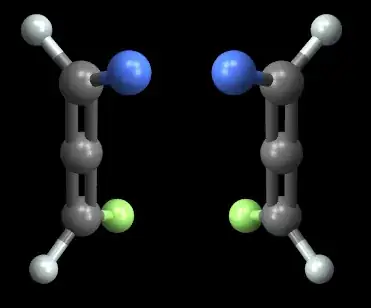

Asked and answered, but I think one thing that's missing is that allenes are not planar like alkenes or alkynes are. You can refer to this question for an explanation.
The dihedral angle between the two halogens is 90 degrees (ideally). Here's an animation hopefully providing a better view of the 3D structure:
This results in the two mirror images being non-superimposable upon each other, which means the molecule satisfies the criterion for chirality. If you rotate the right-hand molecule by $90^\circ$ such that the blue and white atoms at the top coincide, the green and white atoms will not match each other.
In general, any allene with the formula $\ce{R^1R^2C=C=CR^3R^4}$ will be chiral as long as $\ce{R^1}\neq\ce{R^2}$ and $\ce{R^3}\neq\ce{R^4}$. In this case we have $\ce{H} \neq \ce{Br}$ and $\ce{H} \neq \ce{Cl}$, so the compound in the question is chiral.
If $\ce{R^1} = \ce{R^2}$ or $\ce{R^3} = \ce{R^4}$, then the compound will possess a mirror plane and will therefore be achiral.
