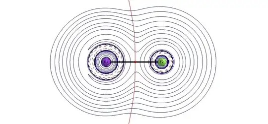

Let's look at a covalent bond, before we look at the bifluoride ion. In this example I chose $\ce{HF}$ as it is related to it. Here we find a completely different picture. The electron density at the bond critical point is a lot larger, $\rho(\text{BCP})=0.366~\mathrm{e\, a.\!u.^{-3}}$ and the second derivative at this point is negative, $\nabla^2\rho(\text{BCP})=-2.858~\mathrm{e\, a.\!u.^{-3}}$. In the graphic one can see that there is charge accumulation along the bond path. All these criteria suggest, that this is a predominantly covalent bond.
QTAIM Laplacian plot of HF
