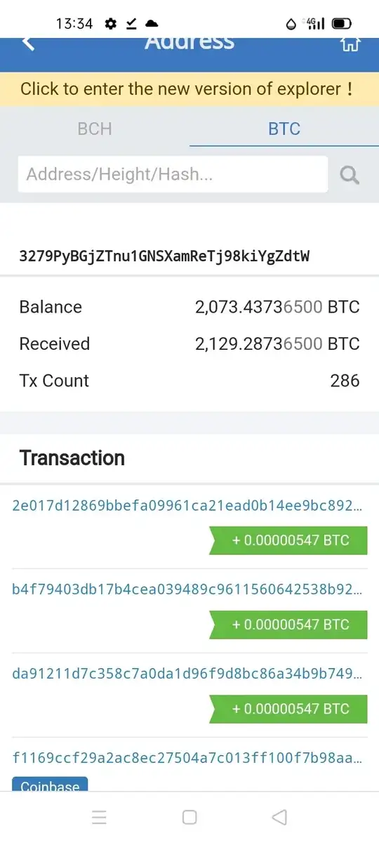

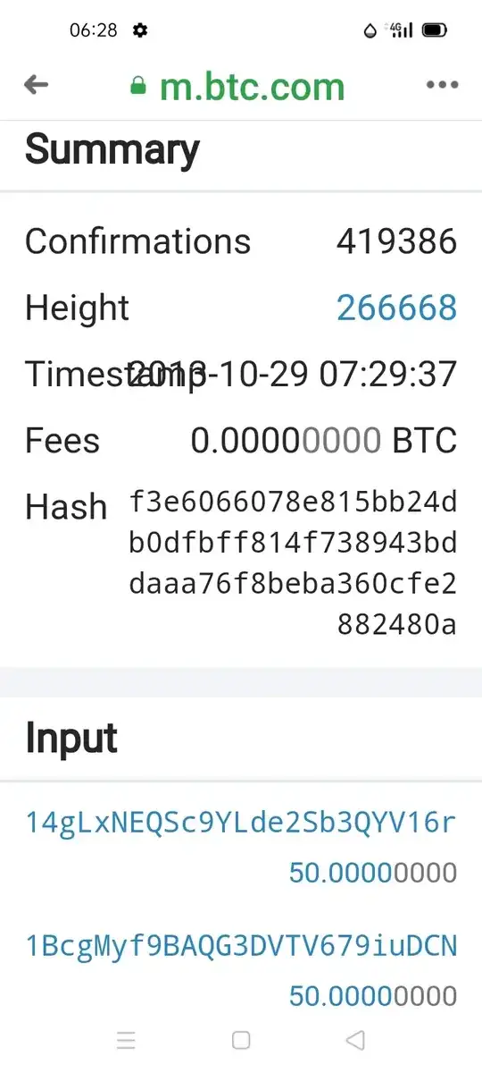

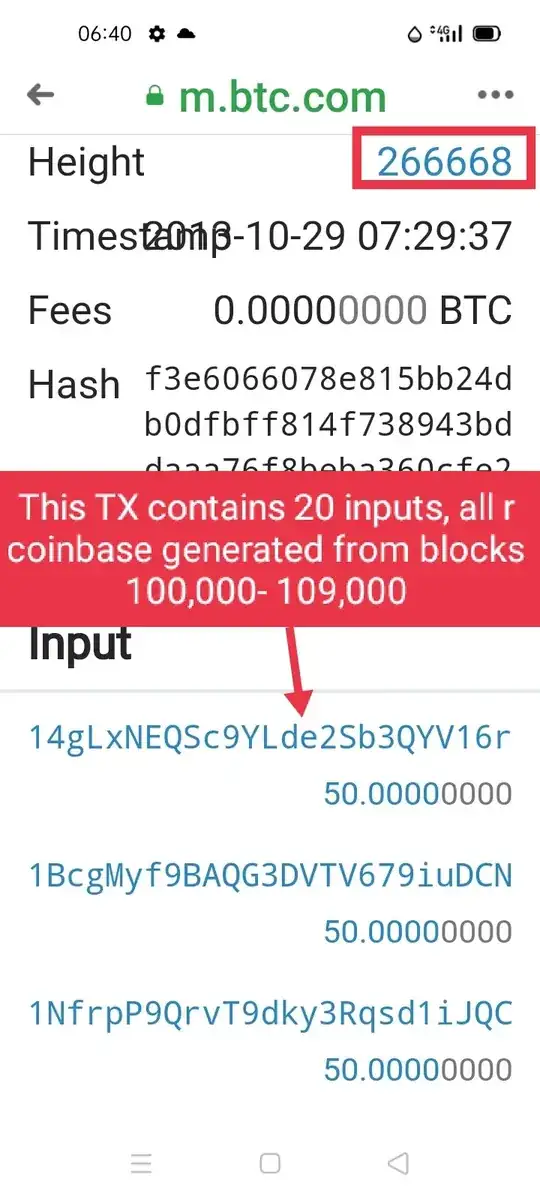

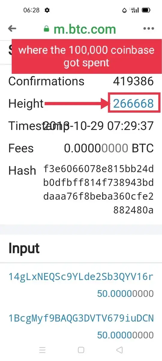

-either start by the block # ( if there's say more than 1000 TXs in the block it would be hard to check this way) ex. These photos show how did I checked that the coinbase UTXO of block 100,000 got spent in block 266,668 enter image description here enter image description here enter image description here

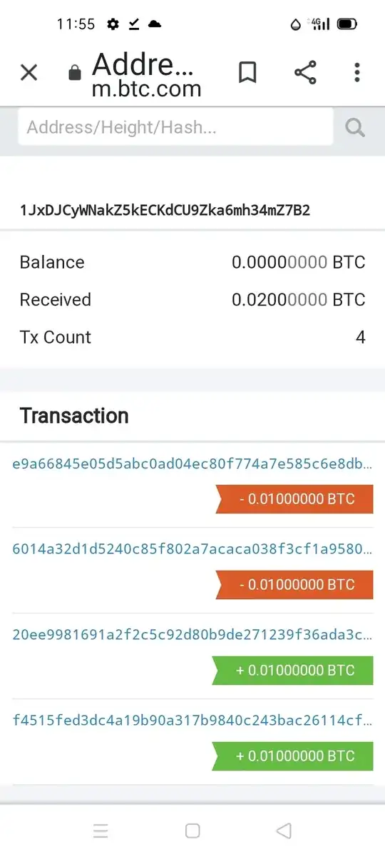

-or by the given user address, u get something like this Then u search for the UTXO value in the given TX (whether it was input or ouput from the arrow direction & the color as u see here) enter image description hereenter image description here When u click on it, it will get u to the TX created it with block no & all info; say I clicked on in the above link, I get the transaction details & the block no enter image description here
(Yes these r probably wallet addresses, but maybe it would be easier to check from since there's a chronological order while inside one block u don't know what's the index/relative order of ur TX; I mean u didn't say it's given)
