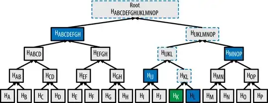

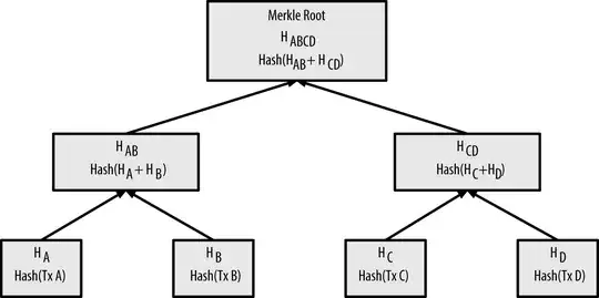

"Figure 7-2. Calculating the nodes in a merkle tree" from Mastering Bitcoin shows the Merkle Root (HABCD) of a list of four transactions: Tx A, Tx B, Tx C, and Tx D: Figure 7-2. Calculating the nodes in a merkle tree
To verify that a transaction—for example, that with hash HK—is a valid transaction (i.e., part of a list of, in this example, 16 transactions with hashes HA, HB, … HP), one need only perform at most 2*log2(N) < N hashes, shown in the Merkle path here:
Figure 7-5. A Merkle path used to prove inclusion of a data element
If HK leads to the correct Merkle root, then TK was in the transaction list.
And the Merkle path, needed to verify Hk corresponds with the Merkle root, only contains 4 hashes in the above example. The Merkle path takes up much less space than storing all the transactions in a block. (In the example above: 4 hashes takes much less space than 16.) This is why SPV is lighter-weight.
In this case N = 16, and 2*log2(16) = 5.55… is indeed less than 16.

  • To verify that a transaction: How do we know the exact location of Hk on the Merkle Tree? @Geremia – alper Dec 05 '17 at 14:19
  • @Avatar To construct Merkle paths from scratch requires knowing all the transactions. Also, forge a fake Merkle path that corresponds to a given Merkle root would be even more difficult than to crack SHA256. – Geremia Dec 05 '17 at 15:53
  • For example from root when we follow: right left right left we reach to Hk, which we want to verify. But how could we know that we should follow that path? @Geremia – alper Dec 05 '17 at 17:02
    @Avator Verification of a Merkle path proceed from the leaf node to the Merkle root. – Geremia Dec 05 '17 at 17:41
  • Got it much clear now. But again how could the algorithm knows that from which leaf should it start from. On your example there are 16 leafs so how could we detect the starting point of the Hk on the tree’s leafs. @Geremia – alper Dec 05 '17 at 18:03
    @Avatar Sorry, I meant to say that one simply needs to search for the transaction in the "list of transactions." – Geremia Dec 05 '17 at 18:56
  • As I understand, we know the index of all transactions that at which leaf they located. @Geremia – alper Dec 05 '17 at 19:16
  • the discussion link seems dead... still haven't found the explain: if it's searched from the "list of transactions", if the position is founded, doesn't it mean that this transaction is a valid transaction? – limboy Jan 14 '18 at 08:51
  • @limboy A SPV server sends a transaction's Merkle path to the lightweight client; this is enough for the lightweight client to verify the transaction is valid, without the lightweight client needing to have a list of all the transactions. – Geremia Jan 15 '18 at 17:35
    The 2nd diagram is the only thing you need to understand everything. The "green" hash H_K is the /claim/ given to the PAYEE (who also has the Merkle root). The VERIFIER (full node) sends the "blue" hashes as /proof/, because they can be used to calculate all of the "blue dashed" hashes all the way up to the Merkle root. If the calculated Merkle root matches the known Merkle root, H_K is in the block. Obviously, the "blue" hashes are a small subset of ALL the hashes, i.e. 2*log_2(N) is less than the whole set N for N > 4. Graph it for yourself at desmos.com, with y=2log(N)/log(2) vs y=N. – Paul Parker Nov 06 '19 at 01:17
