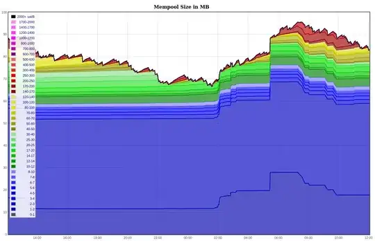

You can currently observe this happening e.g. on Johoe's mempool monitor¹: Last 24h of BTC (default mempool)
As you can see, the 1-2 sat/B band dropped around 7am that morning when the node's mempool exceeded its limit.
¹Note that there are two BTC views and the linked and relevant in this case is BTC (default mempool))
