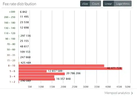

The information doesn't look useful. Distribution of fee rates used by unconfirmed transactions can be checked on many websites like https://mempool.space/ https://mempool.observer/ https://btc.bitaps.com/
mempool-fee-dist

  • Thanks! It's probably obvious to those that know, but what are the numbers in the first plot? I guess the second set is the count in that bucket of the distribution, but what's the first set? (i.e. the one starting at "1-2" and going to ">300"). Is it the transaction fee in satoshis? – stevec Mar 21 '21 at 03:25
  • X-axis: Virtual Size Y-axis: Fee rate in sat/Vbyte. Nodes use limit for mempool size which is 300 MB however Virtual size of transactions in the mempool is different from how much block space they would take up: https://bitcoin.stackexchange.com/a/96070/ –  Mar 21 '21 at 03:32

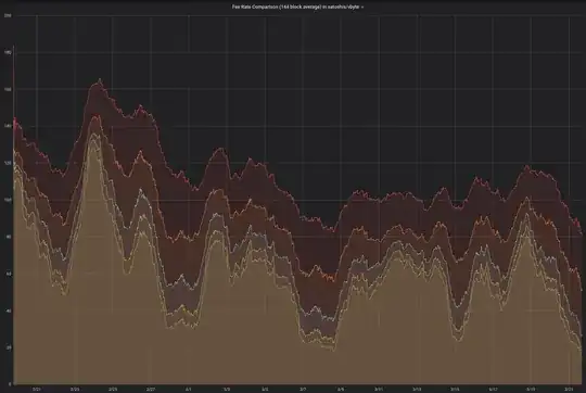

You may find this block feerate composition graph (via Bitcoin Optech Group) interesting to get a sense of how feerates changed historically. While the data is a bit noisy for single blocks beyond a day or two, the 12-block average gives a sense of how fee rates change over the course of a day and the week, while the 144-block average may be interesting for bigger timeframes:
Bitcoin Optech Group's block feerate percentile graph

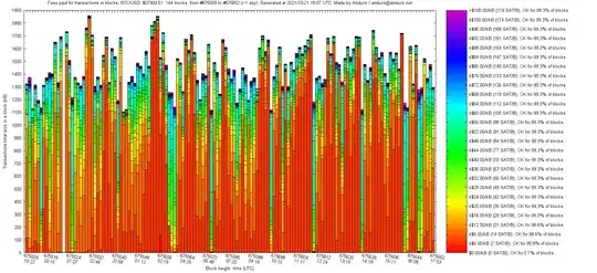

There is also this graph by Anduck that splits out blocks more precisely, but only for the recent past:
Anduck's 144-block fee per transaction chart
