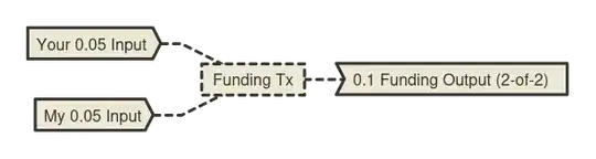

We negotiate to each send 0.05 BTC into a shared 2-of-2 multisig output, the channel funding output.¹ This will require a transaction on the Bitcoin blockchain.
We are planning to use a 0.05 ₿ input each to open a channel

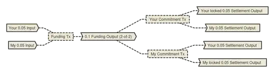

As a “balance sheet” and escape hatch, we negotiate a 2-of-2 multisig transaction that pays out 0.05 BTC to you and 0.05 BTC to me. We call this the commitment transaction.
We add a commitment transaction to make sure that either of us can withdraw their funds
The commitment transaction comes actually in two variants. I sign your commitment transaction and give it to you. If you want to put it in effect, you need only add your own signature and broadcast it to the Bitcoin network. Vice versa, you sign and give me my copy of the commitment transaction. The commitment transactions are future transactions for the Bitcoin network, they're just not valid yet because we have not actually created the channel funding output yet, and because they are each missing one signature. The commitment transaction comes in two variants because the copy you and I hold are asymmetric: your commitment transaction puts a timelock on your Settlement Output, and mine locks my Settlement Output. We’ll see below why we need that.
Your output is timelocked in your commitment transaction, mine in mine
The commitment transaction guarantees that either of us can close the channel and return the funds to our respective controls by themselves. Now that we are confident to be able to to get back our funds, we can sign and broadcast the funding transaction:

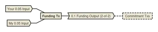

After exchanging the commitment transactions we are confident to broadcast the funding transaction

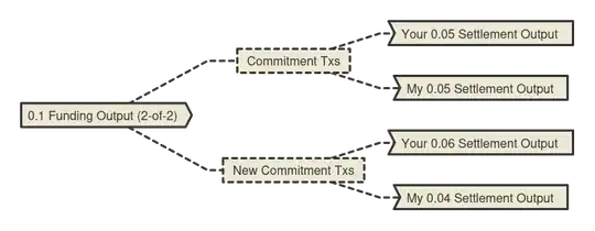

Now, I want to pay you 0.01 BTC. We each create a new commitment transaction ("balance sheet") as before, but this one says that you get 0.06 BTC and I get 0.04 BTC. Each of us gets a new commitment transaction signed by the other to that effect as before.
We add a new set of commitment transactions to update the “balance sheet”.
To make sure that neither of us can use the old commitment transaction the other signed previously, we each create a justice transaction to prevent cheating. The justice transaction allows the channel partner to spend our timelocked output from our first commitment transaction to the themselves if we use the outdated commitment. If we use the correct commitment, the funds go to ourselves after the timelock passes, until then the counterparty can take the funds if we cheated.
I.e. when I try to activate the (now obsolete) 0.05 - 0.05 BTC balance sheet, my paid-out funds are locked for a number of blocks. This gives you time to broadcast the justice transaction in which I signed off on my 0.05 BTC output being sent to you.
If either of us uses the outdated commitment transaction, the other party can take their funds
It's safe for me to give you your justice transaction, or really to anyone, because the justice transaction will only be valid as a response to the fraudulent use of the old commitment transaction.² With the setup as described above, I'd have to come online before the timelock expires to catch an attempt at cheating, but obviously it wouldn't be safe for me to keep payment channels open if I might be offline for extended periods. Luckily, there are watchtower services that take a small payment to monitor for cheating and can broadcast the justice transaction on your behalf when they detect it.

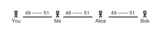

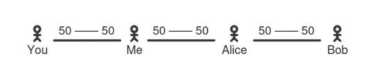

A series of three payment channel: You to Me, Me to Alice, Alice to Bob. Each channel has a balance of 50 on each side.
Now, since you don't have a direct payment channel to Bob (and it would be very inefficient if you had to create a payment channel with every business partner you ever meet), you route your payment through the network. Instead of only writing an update of the balance between Bob and you as I described above, this becomes a concerted effort: Your wallet finds a route from you to Bob that has a) sufficient liquidity, b) least fees, and c) fewest hops. To make a payment, each involved payment channel updates its balances. With a payment of 1 m₿ for the coffee, this updates our network to:

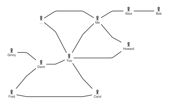

Now, imagine that you don't have only the one payment channel with me, but you have maybe a half a dozen payment channels with other users! :)
A sample network with ten users
