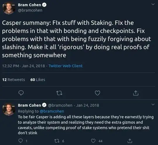

"Casper summany: FIx stuff with Staking. FIx the problems in that with bonding and checkpoints. Fix problems with that with being fuzzily forgiving about slashing. Make it all 'rigorous' by doing real proofs of something somewhere" – Bram Cohen
Source: Bram Cohen describing ETH's PoS research
For example, ETH's effort to switch to PoS has been in research since at least 2015. The latest I've read, ETH's current PoS proposal piles multiple layers of complexity on top of the staking to achieve convergence. Stakers have to register as "Validators" of which there are a limited number, put up a sizeable collateral that can be slashed in retaliation for misbehavior, and additionally maintain frozen capital to stake in the first place. More mitigations are in place to punish validator malfunction and recover the system from such breakdowns.
