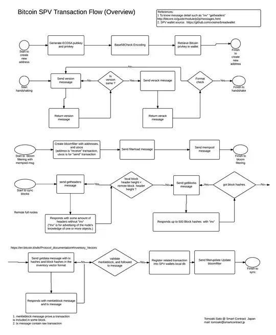

In addition to above answers, You could refer to this diagram if it helps from this link.
Suraj Jain
  • 113
