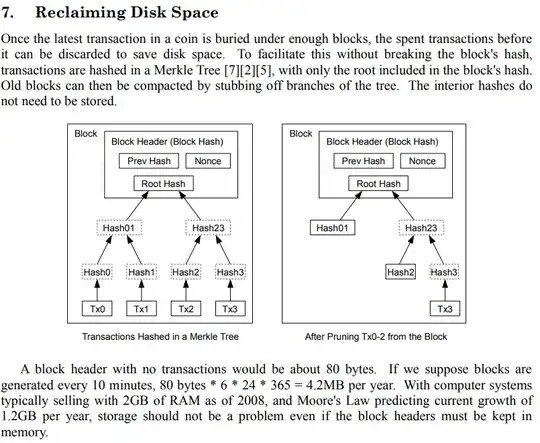

It's been a few years, but I figured I'd add this, since it doesn't seem to be talked about a lot.
First, its important to note that block headers are sacrosanct; they are essential to verifying the blockchain.
However, much of the payload is no longer relevant, since the outputs they generated have already been spent.
It would be nice of they could be removed from the database, wouldn't it? The issue with that, though, is verifying the integrity of the block. If we lose a few transactions, how can we verify that the header's payload hash is right?
To solve this problem, the original Bitcoin paper proposes a solution based on the Merkle Tree.
This tree is constructed by taking a series, hashing every pair of elements, and then repeating the process to that new series.
As the original paper states, this can allow us to remove old transactions, and still be capable of verifying the leftover ones:
BLockchain Paper on reclaiming disk space
  • This answer doesn't seem useful to me. Pruning to reduce the full node disk footprint has been available for years, however, the on-chain pruning proposal as described in the Whitepaper is infeasible and thus was never implemented. – Murch Dec 19 '18 at 21:20
