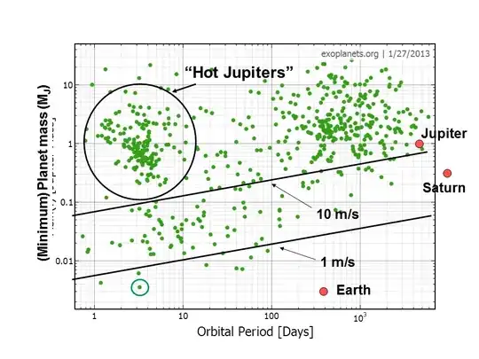

The limits of what are possible are well illustrated by a planet around Alpha Cen B, claimed to be in a 3 day orbit and with a mass similar to the Earth (Dumusque et al. 2012, and see exoplanets.org). The radial velocity semi-amplitude detected here was $0.51\pm 0.04$ m/s, and some spectrographs, notably the HARPS instruments, are routinely delivering sub 1 m/s precision. Thus Jupiter and Saturn would be detectable (but recall, would not have stable orbits), Uranus and Neptune are right on the edge of detectability (remember you can average over many RV observations), but the terrestrial planets would not be found (Earth detections would require precisions below 10 cm/s). Remember also that the weaker signals would have to be dug out from the larger signals due to the Jupiter- and Saturn-like planets.
However, there is a second limitation: to find a planet using the Doppler method you need to observe for at least a significant fraction of the orbital period. Given that current m/s precisions have been available for only $\sim 5$ years, it is unlikely that Saturn would yet have been detected.
A picture that illustrates the situation can be obtained from the exoplanets.org website, to which I have added lines that approximate where RV semi-amplitudes would be for 10 m/s and 1 m/s precision (assuming the Alpha Cen A mass and circular orbits). I've marked on the Earth, Jupiter and Saturn. Note that few objects have been discovered below the 1 m/s line. Also note the lack of planets between the 1 and 10m/s lines with periods longer than a couple of years - the recent increase in sensitivity has yet to feed through to lower mass, longer period exoplanet discoveries.
Planet mass vs period
In conclusion: only Jupiter would have been so far found by the Doppler technique.

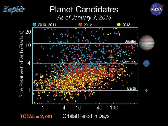

The Kepler satellite is/was capable of detecting very small transiting planets thanks to its very high photometric precision (the dip in flux is proportional to the square root of the exoplanet radius). The picture below, presented by the NASA Kepler team (slightly out of date now), shows that planetary candidates have been discovered that are down to the size of Mars. However these tend to be in short period orbits because a transit signal needs to be seen a number of times, and Kepler studies this patch of sky for about 2.5 years (when this plot was produced).
So from this point of view, possibly Venus would have been seen, but none of the other planets could be confirmed.

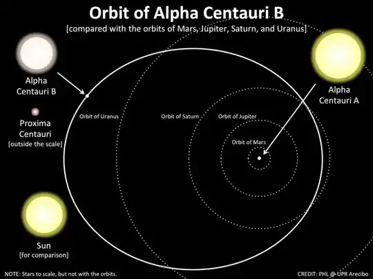

Alpha Centauri A is a binary star with Alpha Centauri B and they are close enough in size to have no stable L4 or L5, so anything that orbits either one of them would need to be either very close (Mercury distance perhaps Venus) or very far and very cold, much greater than Pluto distance, orbiting both stars like Proxima Centauri does. *** EDIT *** Professor Rob says up to 3.8 AU could be stable. That's much further than I'd have guessed, but he quotes a source, that's probably right.
If you put a Jupiter in it's solar orbit around A or B, the 3 body effect would almost certainly create a wildly unstable orbit for the planet that likely wouldn't last long, so, one answer to this question is that our solar-system type of orbit around A or B is impossible.

    Orbits within 3.8 au would be stable. Importantly, the habitable zone is within this range. e.g., https://www.nature.com/articles/s41467-021-21176-6 But you are correct that a "Jupiter" would not be in a stable orbit. – ProfRob Feb 21 '23 at 10:24
