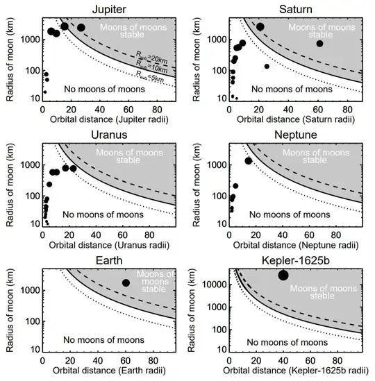

The paper has some graphs showing that there are a few moons in the solar system that can have 10 km-scale submoons that are stable for at least the age of the solar system, under the influence of planet-moon-submoon tides:
Figure 1. Moons of Moons – The parameter space in which the moon of a specified planet could host a long-lived submoon under the action of planet-moon-submoon tides
The authors of the paper note however, that the above graphs do not take into account dynamic instabilities such as the Moon's unusual mass distributions, Sun-Earth perturbations, dynamical interactions between moons in multiple-moon systems, and dynamical scattering events between planets.
