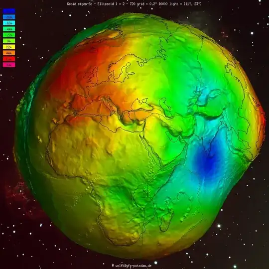

In fact, shown below is what the Earth would look like if you magnified all the various mass/gravity anomolies (such a shape is known as the Earth's geoid). All those irregularities would perturb a satellite if it had to orbit the Earth as close as it would need to orbit the Moon.
Earth's Geoid
I know I kind of side-stepped your question, but I hope you'll agree that the question isn't really meaningful. All bodies have mascons to some degree or another, you can't get away from that.
