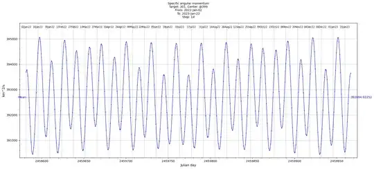

Another important parameter is $\mathbf{h}$, the specific angular momentum. This vector is perpendicular to the orbit, and it's a constant of motion in a one- or two-body system. From Kepler's 2nd law, its magnitude $h$ is half the areal velocity. Thus $h=nab$. Also, $h^2=\mu p$, and $h=r^2\dot\nu$, where $\dot\nu$ is the rate of change of the true anomaly, i.e., it's the body's angular speed in the orbital plane. So if $h$ is constant, the angular speed of an orbiting body is inversely proportional to the square of the distance from the body to its primary. The Moon's specific angular momentum isn't constant, but it only varies by ~1%.

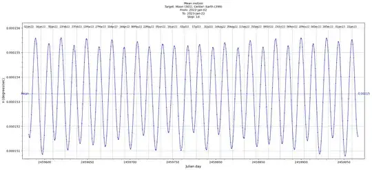

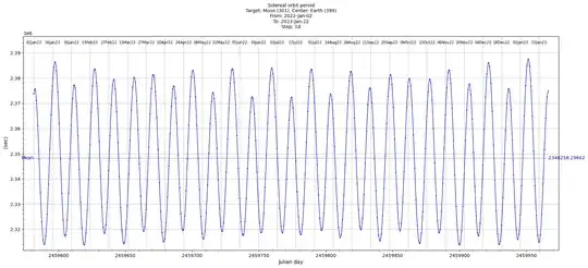

Here are some plots of the main osculating elements that relate to the angular speed. These plots cover the period between two New Moons, 2022-Jan-02 UTC and 2023-Jan-22 UTC, a span of ~13 synodic months, and ~14 of the other kinds of lunar month.
Eccentricity Eccentricity
Semi-major axis Semi-major axis
Inclination Inclination
Mean motion Mean motion
Sidereal orbit period Sidereal period
Specific angular momentum Specific angular momentum
Here's the Python / Sage script that generated those plots (except the angular momentum plot), using data from JPL Horizons. It can generate plots for a few other osculating elements, for any body that Horizons knows.
As you can see, all of these elements vary quite quickly, and the amount of variation is not constant. However, the total amount of variation is mostly fairly small. The semi-major axis varies by ~1%. The inclination varies by ~3%, but that's not so bad because the inclination is fairly small. The worst "offender", by far, is the eccentricity, which is why it's commonly blamed for the variation in the synodic month length.

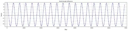

The size of the Moon's mean eccentricity does make a significant contribution to the synodic (and sidereal) month length variation. However, because the Moon's orbit is precessing, changing eccentricity, and changing size, the pattern of synodic month length variation is even more complex.
The maximum variation in the synodic month length purely due to the eccentricities is around 8 hours. Here's a plot showing the month length (from Full Moon to Full Moon) covering 235 synodic months (a Metonic cycle, almost exactly 19 tropical years, and 254 tropical months), in a simplified system where the orbits have the same eccentricities as the real system, and the same tropical & synodic periods, but the orbits are coplanar, with no perturbations.
Simplified system month length differences
The vertical axis shows the difference in month length from the mean synodic length, in hours.
Here's the plotting script, which can also print that data in CSV format, with a few extra items: the month length (in days), and the true anomaly of the Moon at the moment of Full Moon (in degrees).
Interestingly, the variation from New Moon to New Moon in this system, is only ~±4 hours, and between First or Last Quarters it's ~±6 hours.
