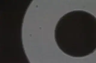

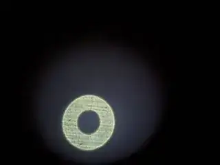

Examples of images from those questions (click for full size if necessary):
out of focus Cassegrain image from https://astronomy.stackexchange.com/q/25914/7982 out of focus Cassegrain image from https://astronomy.stackexchange.com/q/34900/7982

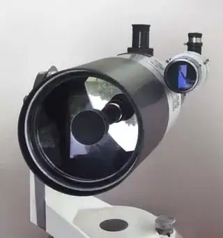

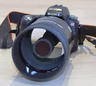

From https://astronomy.stackexchange.com/a/28941/7982 examples of secondary mirror in front that will cause shadows when out of focus (click images for full size if necessary):
"mirror lens" showing secondary mirror "mirror lens" showing secondary mirror
