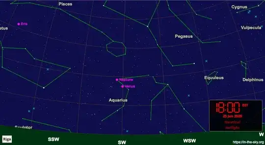

At about 6 PM on 25-Jan-2019 from Riga Latvia the planet Venus was about 17 degrees above the horizon in the Southwest.
Venus is always strikingly bright when it's visible, it's apparent magnitude stays between about -3.8 and -4.8.
From in-the-sky.org's planetarium mode
Screen shot from in-the-sky.org's planetarium mode

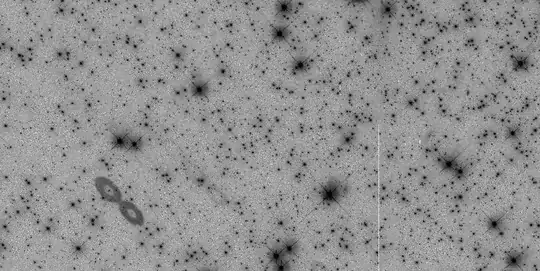

Here are some other celestial donuts to enjoy! In this case they are caused by a tiny spot of dust which is out of focus, and one is dark rather than bright, but they are other examples of how point-like objects that are out of focus show you your aperture.
celestial donut
above: from this answer, below: from this answer
celestial donut
