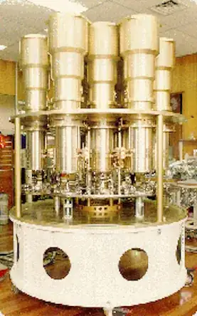

But before I mention them have a look at some "radio" focal planes of discrete receivers to show what I think you are not asking about first:
note: click images for full size
below x2: Cropped from CSIRO ScienceImage 2161 Close up of a radio astronomy telescope with several more in the background.

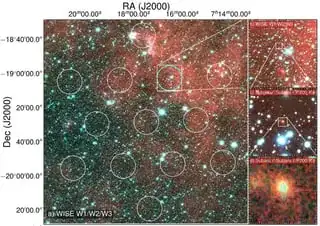

Above: Superposition of the half-power beam widths of the 13-element array of the Parkes 21-cm Mutlibeam Receiver, as used in [a study of a Fast Radio Bursters]http://arxiv.org/abs/1602.07477.

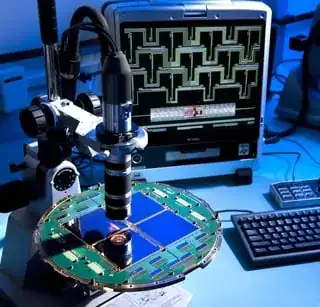

This is from NASA's Superconducting Detectors for Study of Infant Universe
The BICEP2 telescope at the South Pole uses novel technology developed at NASA's Jet Propulsion Laboratory in Pasadena, Calif. The focal plane shown here is an array of devices that use superconductivity to gather, filter, detect, and amplify polarized light from the cosmic microwave background -- relic radiation left over from the Big Bang that created our universe.
The microscope is showing a close-up view of one of the 512 pixels on the focal plane, displayed on the screen in the background.
Each pixel is made from a printed antenna that collects polarized millimeter-wavelength radiation, with a filter that selects the wavelengths to be detected. A sensitive detector is fabricated on a thin membrane created through a process called micro-machining.

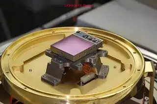

NIRCam, NIRSpec and FGS/NIRISS use mercury-cadmium-telluride (HgCdTe) semiconductor pixel arrays that convert lower energy infrared photons (here 0.6 yo 6 um) to carriers just like silicon sensors do, but they sit above a matching silicon CCD that accepts the charge produced in the low band gap material and do the necessary shifting for readout and transfer to the traditional charge amplifiers and ADCs.
MIRI however uses an arsenic-doped silicon array, based on impurity band conduction rather than the bulk silicon's conduction bands. G. H. Rieke et al. (2015) The Mid-Infrared Instrument for the James Webb Space Telescope, VII: The MIRI Detectors begins:
The detectors of choice for the 5 - 28 µm range are arsenic-doped silicon impurity band conduction (Si:As IBC) devices. They have extensive space flight heritage, for example, arrays of these devices were used in all three Spitzer instruments (IRAC: Hora et al. (2004a); IRS: van Cleve et al. (1995), Houck et al. (2004); and MIPS: Gordon et al. (2004)), in WISE (Mainzer et al. 2008), in MSX (Mill et al. 1994) and in Akari (Onaka et al. 2007). The focal planes on these missions have demonstrated high detective quantum efficiencies, low dark current and relative freedom from other spurious signals, excellent photometric performance, and resistance to the effects of cosmic radiation. Similar detector arrays were selected for the Mid-Infrared Instrument (MIRI) on JWST.
(click image for full size)
Figure 1: A James Webb Space Telescope Near Infrared Camera (NIRCam) detector with optical baffles removed. Light is collected in the purple mercury-cadmium-telluride film. The film is pixelated, although the individual pixels are far too small to be seen by eye here. Credit: University of Arizona/NASA
Source: Goddard Space Flight Center's JWST Infrared Detectors
