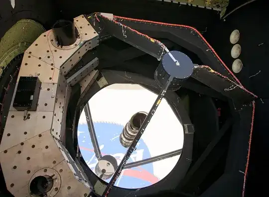

I usually think of SOFIA, the Stratospheric Observatory for Infrared Astronomy as an infrared optical telescope:
SOFIA uses a 2.5 m (8.2 ft) reflector telescope, which has an oversized, 2.7 m (8.9 ft) diameter primary mirror, as is common with most large infrared telescopes. The optical system uses a Cassegrain reflector design with a parabolic primary mirror and a remotely configurable hyperbolic secondary. In order to fit the telescope into the fuselage, the primary is shaped to an f-number as low as 1.3, while the resulting optical layout has an f-number of 19.7. A flat, tertiary, dichroic mirror is used to deflect the infrared part of the beam to the Nasmyth focus where it can be analyzed. An optical mirror located behind the tertiary mirror is used for a camera guidance system.
and one thing that makes that happen is that it looks just like a "normal" telescope with shiny polished and metal coated mirrors.

SOFIA
Source
