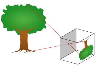

There really isn't a spherical surface, but yes, a "distortionless" telescope maps directions on to a photographic plate or flat CCD sensor similarly to the pinhole camera model which definitely does not convert RA and Dec into completely orthogonal, cartesian coordinates.
