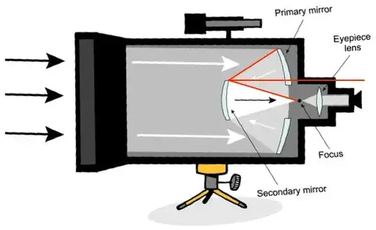

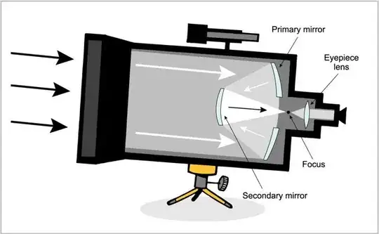

These are two diagrams of Cassegrain reflecting telescopes.
One uses a concave secondary mirror, and the other uses a convex one.
Is there any difference between the two?
For example, does one cost more? Does one produce a better image?
Thanks!

The cartoon illustration shown in the Canada under the stars website shows a meniscus with it's concave side used as a reflector. I think this is just an error by the illustrator. It wouldn't make sense to show a Gregorian telescope in a paragraph about Laurent Cassegrain, and the primary focus does not fall in front of the secondary.
I've tilted the drawing so that the optical axis is horizontal, and highlighted the incoming and reflected rays of light striking the top edge of the secondary. You can see that the reflected ray is more parallel to the axis, which would only happen if the mirror were convex. The very large distance between the lens of the eyepiece, and the actual location of the exit for one's eye confirms that some artistic license has been taken with the optics here.

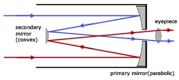

For reference, look at the realistic drawing of a Cassegrain optical system from Wikipedia shown below.
The drawing from the "A-level Physics Tutor" website is also problematic, showing the primary focus far in front of the primary mirror of an optical telescope, followed by an eyepiece lens with the same diameter as the secondary mirror. Again this is artistic license, but there's no excuse for it in a proper physics tutorial.

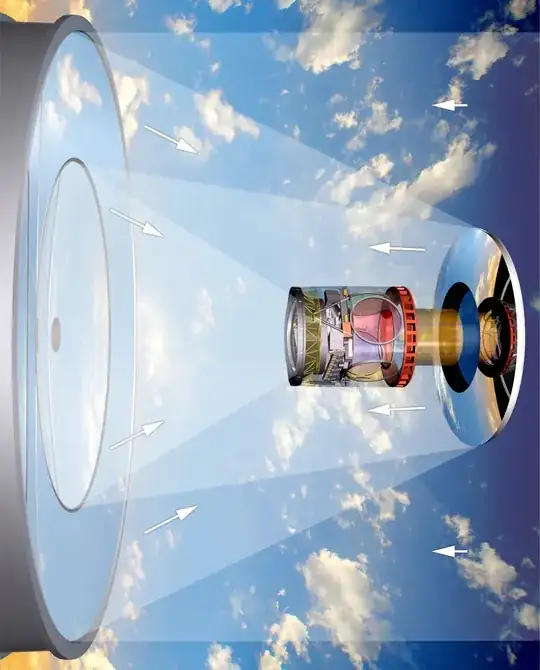

There are examples of optical telescopes where the secondary mirror is so strongly convex that the light then becomes divergent, expanding toward the primary before being refocused (made convergent again) by a tertiary mirror, such as the (crazy/beautiful) Large Synoptic Survey Telescope. See also LSST Optical Design.
above: Drawing of a Cassegrain reflecting telescope, from here.
above: Illustration of the optical system of the Large Synoptic Survey Telescope, from here (rotated).
