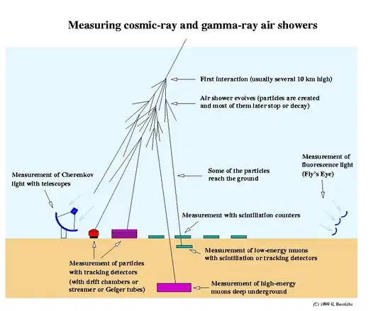

For the highest energy gamma rays however, astronomers use the Earth's atmosphere to convert the gamma rays to a shower of lower energy photons and particles then use a big array of detectors to record the shower and time the individual particles to reconstruct the direction and energy of the gamma ray.
For charged particle or cosmic ray astronomy (e.g. protons and heavier nuclei) you also must go above the atmosphere to directly measure the particles (low energy) but you can also use the Earth's atmosphere to produce a shower.
measuring cosmic ray and gamma ray showers
Measuring cosmic ray and gamma ray showers source
