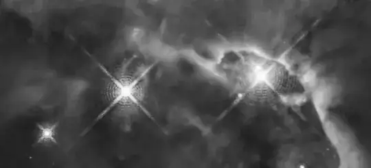

From ESA's HST page heic1819 — Photo Release; Hubble reveals cosmic Bat Shadow in the Serpent’s Tail and What is the cause of all of these sharp, concentric rings around bright stars in this HST image?:
Here's a cropped, monochromed, ROI:
heic1819 — Photo Release; Hubble cropped, monochrome
Further stretched in contrast and size:

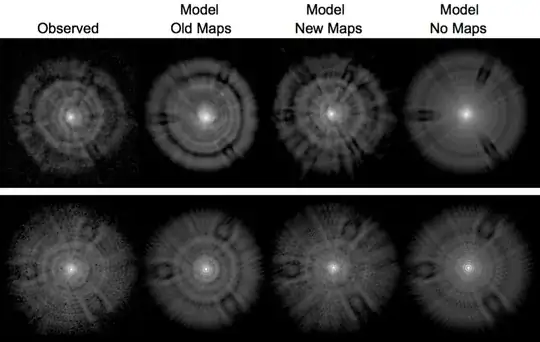

Figure 3. Spherically-aberrated observed and simulated PSFs from the Faint Object Camera using (top) filter F253M (253 nm central wavelength) and (bottom) filter F486N. The models were generated using the old (pre-launch) optical surface error maps, the new maps from phase retrieval, and no surface error maps. Each PSF is approximately 6 arcseconds in diameter. The three lobes are shadows from the primary mirror restraining pads.

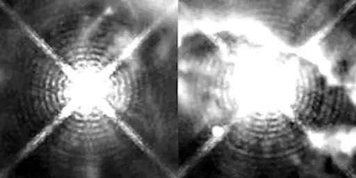

Figure 9. (Left) Long exposure image of the XZ Tauri binary system using WFPC2 PC and filter F675W. An outflow from the system is seen extending to the upper right, but the glare of the PSFs interfere with details closer to the stars. (Right) The image after subtraction of two Tiny Tim PSFs matched to the stars. The diffraction spike residuals have been masked.

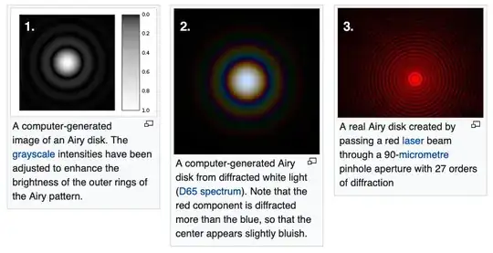

It makes sense that narrow-band AO PSFs should resemble Airy functions. Here are the first 3 figures in the current Wiki article on Airy disk:
Fig. 1 - Usually basic calculations like these are for a single wavelength of light, and you do see the rings.
Fig. 2 visually shows the $\lambda/D$ dependence of the Airy function on wavelength. If the filter is broad enough, this chromatic dispersion would cause the ring to blend into the core, and eventually the photometric curve would look more like a Gaussian. So it's actually BROAD-band filters that show more poorly defined Airy rings than narrow-band.
You might be able to see this effect in Fig. 3 of the original question. The two rows are for filters F253M (top) and F486N (bottom). For HST filters "M" means medium bandwidth and "N" means narrow band. It looks like there is more fine structure in the bottom row, compared to a more blurred radial distribution in the top row, but these PSFs are very complex, and the image is stretched to show the outer halo of the PSF. You can't see the first Airy ring very well at this stretch and magnification.
Fig. 3 - You can clearly see the diffraction pattern from laser illumination, the ultimate real-life narrow-band light!
