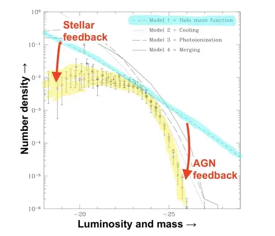

A notable example of this is the halo mass function (HMF) of structures in the Universe, where the distributions of (dark matter halo) masses are well described by power law from the lowest masses out to a "characteristic" mass, after which the number density of object decreases rapidly with mass (Press & Schechter 1974). In fact, many relations in astronomy can be traced back to this hierarchical formalism which has its origin in the assumption that overdensities are Gaussian distributed. Scaling relations between masses, sizes, star formation rates, luminosities, feedback mechanisms, etc. then result in new power laws.
Assuming a constant mass-to-light ratio $M/L$ of galaxies, the luminosity function (LF) of galaxies should follow closely the MF. However, observationally we find that the LF is suppressed at both higher and lower mass scales than the characteristic mass. The reason is thought to be feedback preventing star formation by heating the gas and/or pushing it out of the galaxy; at the high-mass end, you have powerful active galactic nuclei (AGN), while at the low-mass end, where the gravitational potential is smaller, stellar activity can do the job.
Predicted LF assuming a Jenkins et al (2001) with a constant $M/L$ (cyan), and observed $K$ band LF (yellow). Figure from Benson et al. (2003) with my own annotations.

The LF is typically described by a Schechter function. In recent years though we are seeing evidence that the exponential cut-off is a bit too drastic, and that the high-mass end may be better described by another power law, albeit with a steep index, i.e. a so-called broken power law (see e.g. Oesch et al. 2018).
