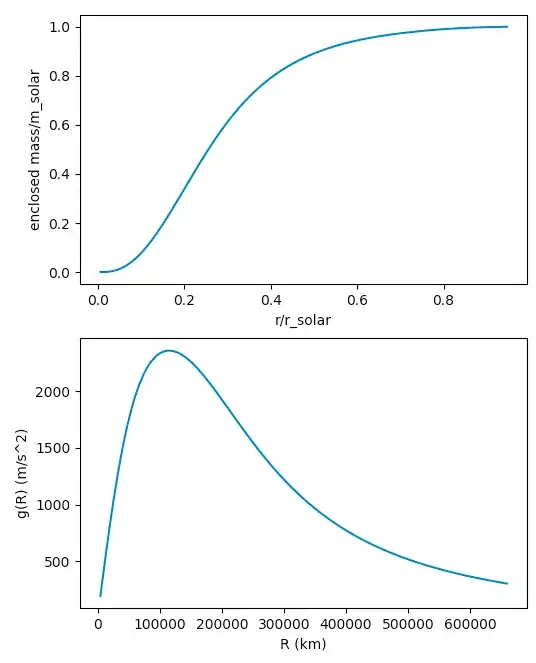

Just for fun I'll plot the data cited in @planetmaker's answer and use the equation there to plot the gravity.
We'll apply Newton's shell theorem to their equation:
$$g(R) = \frac{G}{R^2}\int_0^R \varrho(r) 4\pi r^2 dr = \frac{Gm(R) }{R^2} $$
where $m(R)$ is the mass enclosed by a sphere of radius $R$.
I plotted using this script.
It prints out 31.1 standard Earth gravities at surface
which is close to Wikipedia's 28 Earth gravities. I didn't use interpolation or numerical integration or even Simpson's rule, so a 10% error is not surprising.

plt.plot(r, m)
plt.xlabel('r/r_solar')
plt.ylabel('enclosed mass/m_solar')
plt.subplot(2, 1, 2)
plt.plot(r_real[1:]/1000., g)
plt.xlabel('R (km)')
plt.ylabel('g(R) (m/s^2)')
plt.show()
