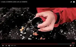

Here is a functioning camera lens made from ice for example, from this answer there:
click images for larger
Source: Mathieu Stern

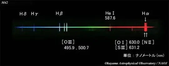

Chromatic abberation is a problem, so use a filter that removes blue and green (I guess you'd call it a red filter) and look at things that are mostly hydrogen.
From Alex Kozik's Orion Nebula spectral composition we can infer that the Orion Nebula would still have the shape of the Orion Nebula in the presence of chromatic aberration if got rid of green and blue light.
From James Kaler's1 The Spectrum of the Orion Nebula:
1Professor Emeritus of Astronomy, University of Illinois
