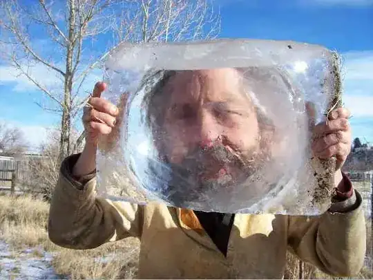

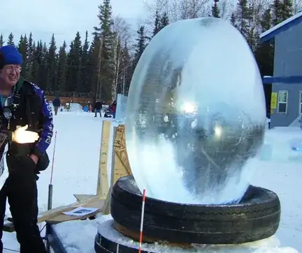

Some related imagery to "get the ball rolling":
From http://wildwoodsurvival.com/survival/fire/ice/ist.html also see Fire from Ice
From http://wildwoodsurvival.com/survival/fire/ice/istmake.html
enter image description here enter image description here enter image description here enter image description here enter image description here enter image description here
From http://www.primitiveways.com/fire_from_ice.html

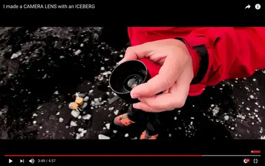

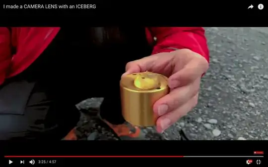

This is a coincidence, but it seems that the photographer Mathieu Stern has been thinking about making and using an ice lens for photography for years. The video linked below was just recently released.
See their blogpost and their YouTube video I made a CAMERA LENS with an ICEBERG.
I'm going to call this an "almost" telescope in that a large refracting telescope exposing directly on to a photographic plate, certainly called a telescope by astronomers, is no different than a camera except that it tends to be much larger. (e.g. What (actually) is the " deprojected half-light radius" of this almost-all-dark-matter Galaxy?)
Here are some of the points listed in the description of the YouTube video
  • First of all the life-span of a lens made of ice is very short, so you can't move very far from where you create the lens.
  • Focusing is extremely hard because of the water melting on the lens itslef.
  • Shaping one " lens" takes 45 min because of the ambiant cold.
  • If your lens breaks in the mold, you have to start all over again
  • I hacked a Japanese cocktail ice ball maker to create half spheres.
  • The housing of the lens was made using a home made 3D print model.
  • All photos where shot during the 1 minute of the last ice lens.
  • The video at the beginning of the video was shot in the last usable seconds of the last ice lens.
  • No I didn't ruined my camera with water damages, even if it was pretty dangerous, I managed to keep the inside dry.
I made a CAMERA LENS with an ICEBERG, Mathieu Stern
