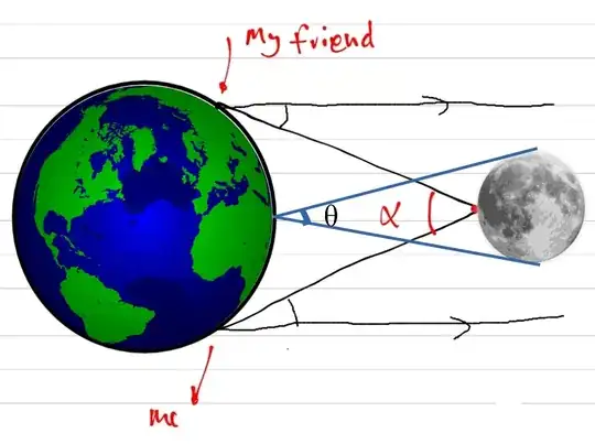

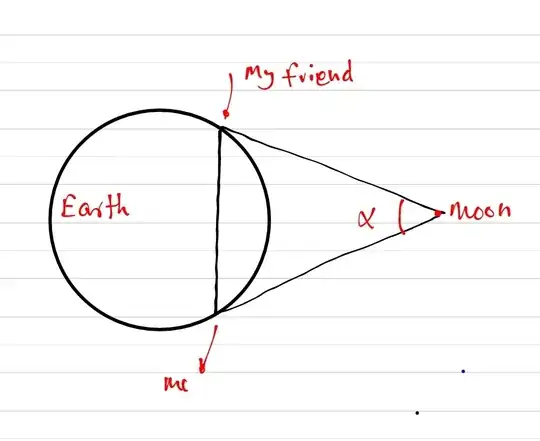

I want to use the parallax method (from scratch) to find the distance between the earth and the moon. To get a significant parallax, I need to choose a large baseline. I live in India and my friend in the US and so the baseline will be about $13,000$ Km. That's quite a large so I suppose I would get a significant parallax.
What I don't think of, is taking of angle measurement?
How can I measure the angle $\alpha$?

    Don’t forget that while ground distance is around 13,000 km, physical distance between you and your friend is less, as you need to account for Earth’s curvature, as your drawing makes clear. The Earth’s diameter is 12,756 km. Also, you can’t directly measure α, as this would imply you’re on the Moon, but you can measure the other two angles… – Pierre Paquette May 08 '21 at 05:59

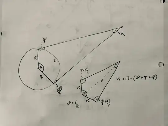

I am sure that measuring the angle compared with distant stars is the best approach, but you can in fact work out the angle even without looking at distant stars, if you assume the Earth is spherical and you know its radius, and you know both the length and the direction of the great circle between you & your friend.
Here's a terrible drawing:
Earth-moon
So here, the radius of the Earth is $R$, and the great-circle distance between you and your friend is $l$. So the angle between you and your friend is $\theta = l/R$ (radians).
Now, you need to agree both to measure the Moon's angle above the horizon at a particularly good moment: that moment is when it crosses the plane defined by you, your friend, and the centre of the Earth. In other words, you need to measure its angle above the horizon as it crosses the great circle between you. This is annoying, because you have to know the direction of the great circle, but it's also nice because you don't need a clock.
So, when you measure its angle above the horizon you get two angles, $\psi$ and $\phi$. And now you have the quadrilateral I drew below the main diagram, and you know three of its angles and two of its sides. The total angle in a quadrilateral is $2\pi$, so this tells you the fourth angle, which is $\alpha = \pi - (\theta + \psi + \phi)$. And you can then go on to solve the quadrilateral for the distance to the Moon, $d$ (I am leaving this out because I can't remember how to do it!)
Note that this will only work if the Moon is above the horizon for both of you when it crosses the great circle: it may not be I think.

  • The moon being in the plane that contains the two observers and the center of the earth certainly simplifies things, but it does not seem necessary. Each observer can in advance figure out the straight line between them and the other observer and then measure the angle of the moon to that line. (Not sure what the required accuracy is, and whether it can be practically achieved.) – Carsten S May 09 '21 at 17:48
  • @CarstenS: but then they need to synchronise their times, which is what I wanted to avoid. –  May 10 '21 at 10:59

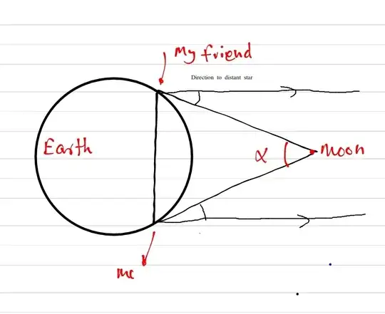

You compare the position of the moon with that of the background of stars. If you both take a picture of the moon at the same time, and compare the angle that it makes with a distant star the moon will be in a different position, and from this you can calculate the angle. Here is your diagram showing, in slightly simplified way what I mean.

    And with the moon you want to make sure to really take photos at the same time. So make sure to synchronize your clocks reasonably well. It moves with about 30" per minute. Take that into account for your error analysis, given the accuracy of your concurrency of the photos to compare – planetmaker May 08 '21 at 09:53
  • Yes, that's alright with the method but there are two problems, first, there is about a $9$ Hour difference between the two cities so it's hard to find the moon with stars. And even if it does, there is too much light pollution and I don't have that sort of camera to capture such an image for measurement. – Young Kindaichi May 08 '21 at 13:30
