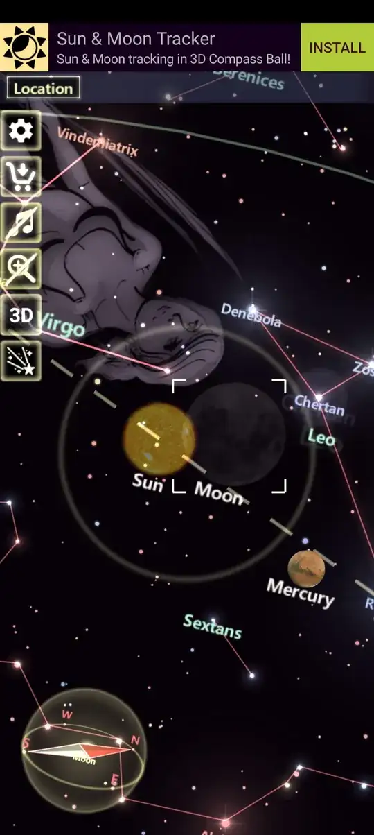

I was looking in the StarTracker android application from Tehran, Iran; and this is the screenshot:
StarTracker
As you can see the Moon covers a small portion of the Sun. The green line above them is the astronomical horizon and the two objects are located at NW direction.
I don't know if it's accurate. But how do people on the opposite side of the Earth (if we draw an imaginary straight line twoards the Sun from my location) see the Moon and the Sun if we assume the location of the objects are accurate on the app?

    The diameter of the moon is way larger in comparison to the Sun's diameter than they ever appear. So the diagram is not accurate. Same for the diameter of Mercury. The app is likely making them larger just to make them easier to identify. – Greg Miller Sep 15 '23 at 03:01
    from the relative size of mercury it seems clear that those are not to scale – njzk2 Sep 15 '23 at 20:41
    @njzk2 No one says scales are accurate. If they wanted to set scales correct they had to depict Mercury with a little sand of salt which would be hard for us to notice. Or the Sun with a disc as large as a great house which wouldn't contain in monitor. – Snack Exchange Sep 15 '23 at 20:48
    "As you can see the Moon covers a small portion of the Sun" - This is only true if the scales are accurate. "No one says scales are accurate" - You can't have it both ways. If you are assuming that the moon covers the sun, then you are implying the scale are accurate. If you're saying the scales are not necessarily accurate, then you have no way of knowing if the moon covers the sun or not. – Todd Wilcox Sep 16 '23 at 04:56
At the time depicted, it is close to a astronomical new moon, and night-time in Tehran. So at that time you can't see the sun nor the moon in Tehran
For people on the other side of the world (i.e. somewhere in the South Pacific Ocean) it is day-time. And the sun and moon are above the horizon. The sun is visible but the moon is not visible at new moon, as it is lost in the glare of the sun.
Of course, twelve hours later the situation is reversed, and it would be day-time in Tehran and night-time on the other side of the world.
Note that while the positions of the sun and moon are correct, their sizes are not. In fact they are both about the size of Virgo's eye (in the drawing used in that app) And at that time, the moon does not cover any part of the sun.
Moreover for some reason that app is using a picture of the planet Mars to represent Mercury.

    Should be noted that 12 hours later the Moon will move significantly from its current position relative to the stars, about 6-7 degrees, more than 10 times of its diameter. The values here are imprecize because of eccentricity of the moon's orbit. – Heopps Sep 15 '23 at 08:10
  • Mars itself is represented by a very red disc that has a little groves on it. – Snack Exchange Sep 15 '23 at 08:52
