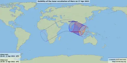

Recently I found a fantastic website in-the-sky.org, from here we can simply pick up any astronomical event and check its visibility in any part of the Globe. For occultations, for example, we have very nice maps like this below:
There are a lot of conjunctions, occultations, eclipses, and so on described fairly in detail. I think it's the best website so far for people making Astro calendars.

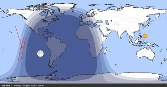

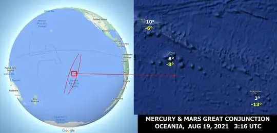

The problem is, that if I checked some conjunction i.e. Mercury with Mars on August 19, 2021 I spent quite a lot of time checking which located around the Globe is the best for watching this event. I took into consideration the solar depression, not lower than 6 degrees (end of civil twilight), and an altitude of these 2 bodies above the horizon (not lower than 3 degrees due to atmospheric extinction). Finally, my hand-sketched maps are looking like this:
Day and Night Map Timeanddate.com
plotted in the Day & Night Map at timeanddate.com
sketch plotted in Google Maps

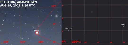

Circumstances checked with stellarium-web.org
