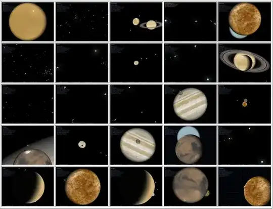

I'm still looking, but my current conclusion is that there is no good well-known non-iterative way to find planetary conjunctions. As the image in my https://mathematica.stackexchange.com/questions/92774 shows, planetary separations aren't really as well-behaved as I had hoped.

Some of the "cooler" conjunctions I found are at: http://search.astro.barrycarter.info/table.html. Here's a screenshot:
