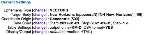

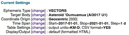

Below: Plots of the distance of ʻOumuamua (bumpy, blue) and the New Horizons spacecraft (straight, green) from Earth as a function of years since 2017-01-01.
distance from earth after 2017-01-01 for New Horizions (straight green) and ʻOumuamua (bumpy blue)
JPL Horizons
JPL Horizons
