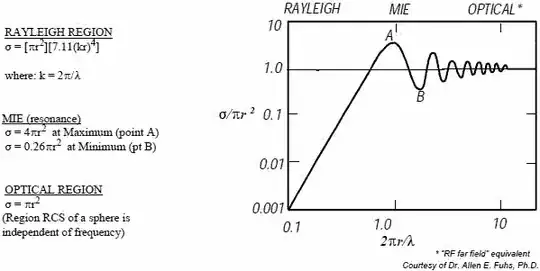

The figure below (from here) shows $\sigma / (\pi r^{2})$, which is the "effective" scattering cross section relative to the geometric cross section of a scattering object, plotted versus the size of the object $r$ relative to the wavelength of light $\lambda$ (e.g., the radio waves used in radar). When the size of the object is roughly the same size as wavelength of light, or larger, it efficiently scatters them: its effective cross section is roughly the same as its geometric cross section (ignoring other effects such as chemical composition, surface roughness, etc.). Sometimes it can even be several times larger!
But when the objects become smaller than the wavelength, you transition to the Rayleigh scattering regime, where the scattering depends on the size of the object to the sixth power.
Imagine a sphere 10 cm in radius, roughly the same as typical radar wavelengths (so $2 \pi r / \lambda \sim 1$). It will have an effective cross section similar to its geometric cross section: about 300 cm$^2$. Now imagine subdividing that object into spheres one-tenth the radius. This would mean about 1000 objects 1 cm in radius (so that the total volume is the same), with a total geometric cross section of about 3000 cm$^2$ (realistically a little less, because of shadowing). But the plot shows that the effective cross section goes down by a factor of 1000, so the total radar cross section of all the small objects -- and thus the backscattered energy of the radar waves -- would be ten times smaller than it was for the single big object of the same total volume. And that's just for a reduction in size of ten; in reality, we're talking about going from centimeter-to-meter-sized objects (the ring) to sub-mm and micron-sized cloud particles in Saturn's atmosphere.
This is why weather radar on Earth can show you precipitation (rain, snow, hail) -- because the raindrops/etc. are large (a few mm in size), and can scatter radar waves with some efficiency -- but usually can't show you clouds -- because the water droplets making up clouds are so small. (And obviously radar wouldn't be nearly as useful to the military if it was easily scattered by clouds.)
So -- absent floating chunks of centimeter- or large-sized ice in the upper atmosphere of Saturn -- you're not going to get much of a radar return from Saturn itself. The original discovery of radar returns from the rings surprised people, because the assumption had been that the rings were made up of very small (e.g., micron-sized) bits of ice, which wouldn't efficiently reflect radar waves either.
