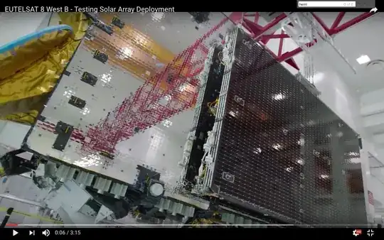

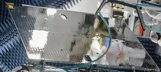

Shiny surfaces on communications satellite
From How do commercial broadcast satellites in GEO produce such carefully shaped signal footprints? you can see thermal radiators that are highly reflective in the visible (and near IR)

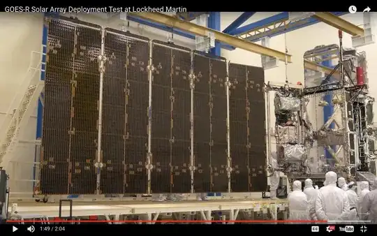

From How will GOES-R simultaneously point some instruments down at Earth and others sunward?
