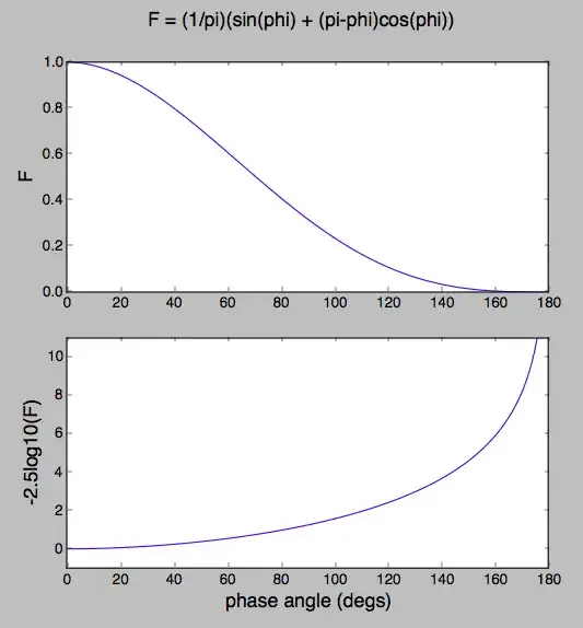

The dependence is given by the term
$$ \frac{1}{\pi}(\sin(\phi) + (\pi-\phi) \cos(\phi))$$
and looks like

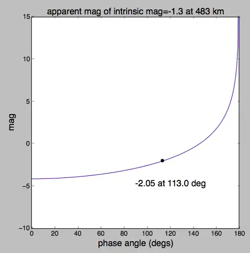

For the satellite in the question at a distance of 483 kilometers and an intrinsic magnitude of -1.3, the the apparent magnitude seems to be about -2.0 and its dependence on phase angle is as follows:

import numpy as np
halfpi, pi, twopi = [f*np.pi for f in (0.5, 1, 2)]
degs, rads = 180/pi, pi/180
Mintrinsic   = -1.3
d_kilometers = 483.
phase_angles = np.linspace(0, pi, 181)
Mapp = Mapparent_from_Mintrinsic(Mintrinsic, d_kilometers, phase_angles)
# https://astronomy.stackexchange.com/q/28744/7982
# https://www.researchgate.net/publication/268194552_Large_phase_angle_observations_of_GEO_satellites
# https://amostech.com/TechnicalPapers/2013/POSTER/COGNION.pdf
# https://apps.dtic.mil/dtic/tr/fulltext/u2/785380.pdf
if True:
    plt.figure()
    F = (1./pi)*(np.sin(phase_angles) + (pi-phase_angles)*np.cos(phase_angles))
    plt.suptitle('F = (1/pi)(sin(phi) + (pi-phi)cos(phi))', fontsize=16)
    plt.subplot(2, 1, 1)
    plt.plot(degs*phase_angles, F)
    plt.ylabel('F', fontsize=16)
    plt.subplot(2, 1, 2)
    plt.plot(degs*phase_angles, -2.5*np.log10(F))
    plt.xlabel('phase angle (degs)', fontsize=16)
    plt.ylabel('-2.5log10(F)', fontsize=16)
    plt.ylim(-1, 11)
    plt.show()
if True:
    plt.figure()
    plt.plot(degs*phase_angles, Mapp)
    plt.plot(degs*phase_angles[113], Mapp[113], 'ok')
    plt.text(90, -5, '{:0.2f} at {:0.1f} deg'.format(Mapp[113], 113), fontsize=16)
    plt.ylabel('mag', fontsize=16)
    plt.title('apparent mag of intrinsic mag=-1.3 at 483 km', fontsize=16)
    plt.ylim(-10, 15)
    plt.show()
