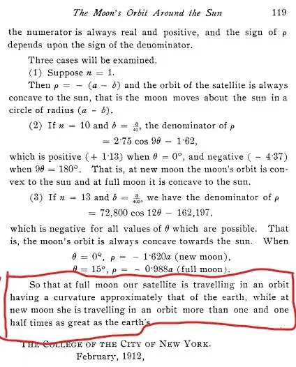

I have gone through the following paper by A B Turner titled The Moon's Orbit Around The Sun.
In this, the author concludes that the curvature of the Moon's orbit around the Sun in the new moon positions, $k_n$ is approximately 1.5 times of the Earth's orbit around the Sun, which is approximately the same as that of the Moon's orbit around the Sun in the full moon positions, $k_f$.
$k_n$$\approx 1.5k_f$, which is intuitive considering the fact that in the new moon positions, the moon experiences gravity from both the Sun and the Earth in almost the same direction.
My question is, then, how does the Moon's orbit manage to not have any concavity, no matter how minute, while transitioning from the full moon to the new moon positions? Isn't that not a mathematical impossibility?

Turner's expression for the radius of curvature ρ is correct, but in case (3), ρ = -0.988 a where the Moon is in the first or last quarter (θ = 7.5° or 22.5°). Where the Moon is full (θ = 15°), ρ should be -0.749 a.
Case (1) models a spacecraft stationed at L1 (b = a / 100, ρ = -0.99 a) or L2 (b = -a / 100, ρ = -1.01 a), roughly 4 times the lunar distance from the Earth.
The case (2) example b value is too large for a stable orbit around the Earth. Instead we can model a geosynchronous satellite with n = 366 and b = a / 3550. Then ρ is +0.0218 a on the day side and -0.0314 a on the night side. This trajectory is alternately concave toward and away from the Sun, resembling Turner's figure 1 but with shorter waves.
Between cases (2) and (3) we can find parameters such that, on the sunny side of the Earth, the ρ expression denominator approaches zero and the trajectory is momentarily straight. This is nearly the case if n = 24 and b = a / 575, corresponding to a 15.2 day orbit at 0.677 lunar distance.

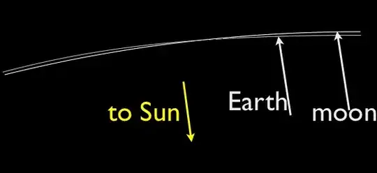

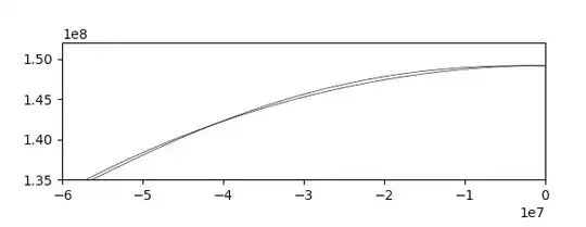

Here's a quickie of what the Incorrect View would look like if it were correct per request in comments:
quickie of how the Moon and Earth move around the Sun
