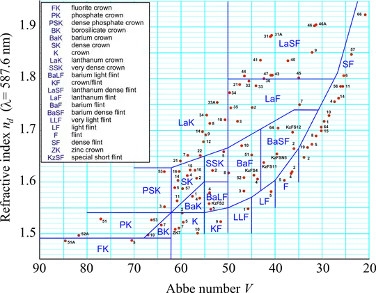

A fouth approach to add to @Uhoh's 3 others, is to make the lens of extra low dispersion glass. Dispersion is a measure of how refractive index varies with colour. However such glass is relatively difficult to make, in the quality required for lenses, and so rather expensive.
Further information about dispersion can be found on this wikipedia page https://en.wikipedia.org/wiki/Abbe_number
Here's a plot of Abbe numbers and indices of refraction for various glasses. The ultra-dense flint glass types have the lowest Abbe number. Source
