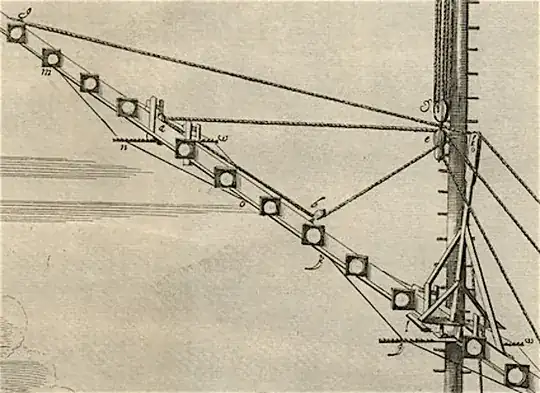

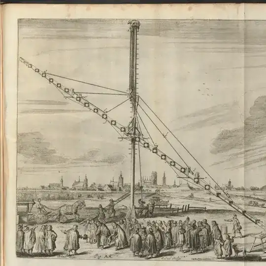

Below are two cropped views of "Johannes Hevelius's 8 inch telescope with an open work wood and wire "tube" that had a focal length of 150 feet to limit chromatic aberration." from Harvard University, Houghton Library, pga_typ_620_73_451_fig_aa (found here) the first of which I've zoomed and enhanced the contrast.

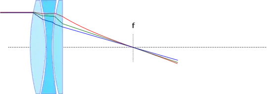

A refractor's primary lens produces an image because the angle it deflects is proportional to the distance $x$ from the center of the lens of focal length $f$ as
$$\theta \approx x/f$$.
For a dispersive material the deflection at a given point on the lens varies with wavelength, and therefore the focal length of the lens varies with wavelength.
enter image description here Source
This is called chromatic aberration and its severity for a given type of glass is often expressed by its abbe number.

Now, if you study the properties of lenses, you notice that divergent lenses (the kind that make the image smaller) have a chromatic aberration opposite to convergent lenses (lenses that magnify, and that were used as primary, or objective lenses in telescopes back then). It could be argued that by combining a convergent and a divergent lens, chromatic aberration might be greatly reduced; as long as the convergent lens is stronger than the divergent companion, the combination should remain convergent.
Also, different glasses need to be used, so that the convergent lens is strongly convergent, but weakly dispersing, while the divergent lens is weakly divergent, but strongly dispersing. That's how you get near zero dispersion, but still pretty decent convergence.

The answer lies in your first image. You see how the different colours are refracted differently? This is for a very-short-focus lens. The cone of light between the lens and the image is very wide—the angle between the top and bottom rays is very wide.
Now, when you have a long-focus lens, this cone of light becomes narrower and narrower. The relative space between each “colour-focus” becomes smaller. So you end up with red and blue rays focused almost in the same place, at least proportionally speaking.
