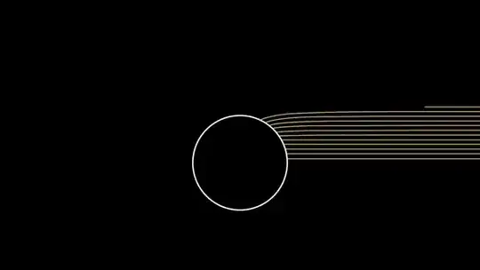

So we might think that because of the absence of light coming from these region inside the event horizon an external observer might see a black ball of 1 Schwarzschild radius (which is the physical size of the even horizon), but this is not correct. Even if the event horizon marks the physical boundary between both regions the fact is that due to the extreme light bending the actual image of the event horizon (its "shadow") is a distorted view of this surface. For a classical non-rotating black hole this "shadow" (we call a shadow the image created by the absence of light rays but we can trace it with hypothetical "dark rays" that behave in the same way) looks like a ball with 2.6 Schwarzschild radii in size. Much larger than the actual event horizon! To visualize this I can only point to this fantastic explanation by Derek Muller from whom I took this animation.
As you can see we are throwing light rays from infinity into the black hole (that's why they are all parallel in the beginning). Our light rays fall reach the event horizon even if they were not directly pointed there, because they curve. Since light paths can be reversed and the physics still hold we can talk about light rays coming from different parts of the event horizon and reaching the outside observer in the reversed paths. So as you can see not only light rays emmited just barely outside the event horizon pointing towards us will reach us but also rays coming from "the back" of the event horizon can reach us. And as you can see those rays would create an enlarged image of the event horizon since they seem to come from a region located farther than the event horizon itself. So when you look to a real black hole from outside you will see this "black shadow", which is a map reprojection of the surface of the true event horizon where you can see even the 100% of the surface of it from a single vantage point.

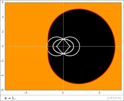

If you apply this reasoning to photons you can start to notice something interesting. Light coming from far away stars behind the black hole as viewed from an outside observed gets bent in different ways if it is coming from one side or the other due to this frame-dragging effect. If the light ray is coming parallel over the rotating surface of the black hole it is going to be helped by the black hole itself, and some of the angular momentum is going to be transfered to that light ray from the Kerr black hole. If instead the light ray comes anti-parallel to the rotation (which is going to happen in the other side of the black hole), then it might never reach the observer. This reasoning can be applied to the "dark rays" (which do not exist but is a way to trace the shadow which is the absence of light rays) coming from the event horizon and thus the shadow of the black hole is no longer a perfect black disk but an asymetric D-shaped black region, that tells you if the black hole is rotating clockwise or counter-clockwise.
In this animation you can see the appearance of the shadow of the black hole when we increase its rotational speed, as you can see it goes of-center and asymetric as we increase it.

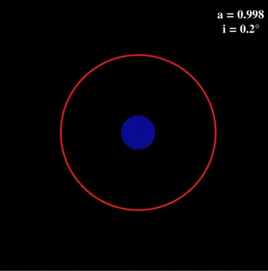

Since frame-dragging goes as the mass rotates you can't notice it so strongly if you watch the black hole from another inclination. In fact the projected rotational speed if you watch a black hole from the poles ($i = 0^\circ$) is zero, and thus the black hole would look just like a non-rotating one. Here you can see the dependance of the shape of the shadow (in red) of a Kerr black hole with a fixed rotational speed when you see it from different inclinations (from the equator to the poles). The event horizon is represented in blue (but remember, you don't see that, you only see the shadow)
As you can see the effect is the same in both cases (changing view angle for a fixed rotational speed vs. changing rotational speed for a fixed inclination), which means that you can't tell the real rotational speed of a black hole just by measuring the shape of the shadow (a disk like shadow could mean a non-rotating black hole or a Kerr black hole as viewed from above for example), but at least it gives you a minumim estimate for the rotation. To study the exact rotational speed we need some independent measurements like for example the inclination of a disk of material around it. In those cases you would have complete information about the angular momentum of the black hole.
