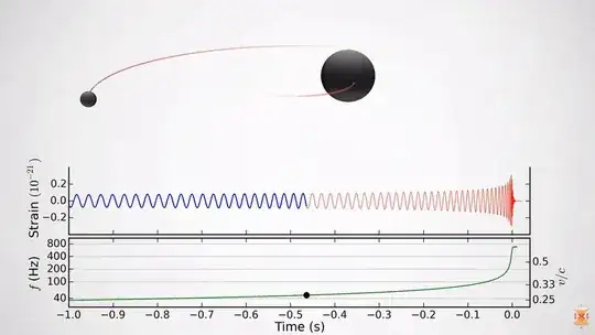

See for example the SXS Collaboration video: "Inspiral and merger of binary black hole GW151226":
Black Hole Spin

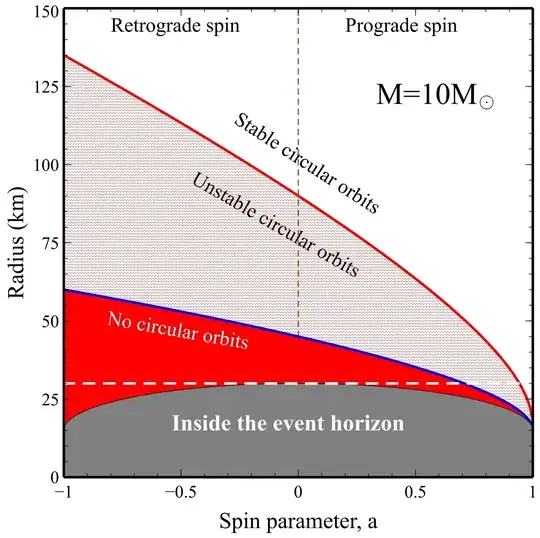

    In this Review, I will survey the current state and future promise of black hole spin measurements. For much of the past 20 years, quantitative measures of spin have been the domain of X-ray astronomy, and these techniques continue to be refined as the quality of the data improves. With the recent advent of gravitational wave astronomy, we now have a completely new and complementary window on spinning black holes. Furthermore, we stand on the threshold of anothernmajor breakthrough, the direct imaging of the shadow of the event horizon by global mm-band Very Long Baseline Interferometry, aka, the Event Horizon Telescope (EHT). We are truly entering a goldenbage for the study of black hole physics and black hole spin.
    While the original Penrose process may be hard to realise in nature, Roger Blandford and Roman Znajek showed that magnetic fields can similarly extract rotational energy from the ergosphere. Magnetic spin-extraction is the.leading theoretical model for the driving of relativistic jets from black hole systems.
    To be more quantitative, we consider a black hole with mass $M$ and angular momentum $J$. We can define the unitless “spin parameter” by $a = cJ/GM^2$ where $c$ is the speed of light and $G$ is Newton’s constant of Gravitation. The Kerr solution tells us that the structure of the spacetime around a spinning black hole depends only on $M$ and $a$. As well as greatly simplifying any GR treatments of black hole astrophysics, this provides a route to observational explorations of gravity theories beyond GR — once the mass and spin of an astrophysical black hole has been measured, we can in principle search for deviations of the inferred gravitational field (including any gravitational radiation) from the predictions of GR.
    If one were to spin a planet or a star too quickly, it would fly apart as the centrifugal forces overwhelm the gravity that binds the object together. There is an equivalent situation for a black hole. The Kerr solution shows that, if $|a| > 1$, there is no longer an event horizon. GR would then predict a naked spacetime singularity, an outcome that is abhorrant to physical law and the notion of predictability and thus forbidden by the Cosmic Censorship Hypothesis. Of course, it is of great interest to physicists to test whether nature respects this Kerr limit.".
    Page 3:
    Figure 1
    Figure 1: Location of some special orbits in the equatorial plane of a Kerr black hole as a function of spin parameter. Shown here is the innermost stable circular orbit (red line), photon circular orbit (blue line), static limit (dashed white line), and event horizon (bounding the grey shade). Positive/negative spin parameter corresponds to spin that is prograde/retrograde, respectively, relative to the orbiting matter (or photons). The vertical dashed red line separates the prograde and retrograde cases. Circular orbits are stable outside of the innermost stable orbit but become unstable inside of this radius (region denoted by light red shading). Circular orbits do not exist interior to the photon circular orbit (region denoted by solid red shading). For concreteness, a 10 solar mass black hole is assumed. Radii for other masses can be obtained using linear proportionality.
