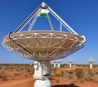

below x2: Example of a small dish with a focal plane array, cropped from CSIRO ScienceImage 2161 Close up of a radio astronomy telescope with several more in the background. Click for full size.
There are more radio telescope focal plane array images in this answer and a lonely one in this answer.

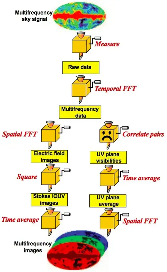

That the two different processes can both be used to produce wide-field images when the antennas are on a regular array is shown in Figure 1 of your linked paper, Tegmark & Zaldarriaga 2009 The Fast Fourier Transform Telescope, and some differences are nicely summarized in the caption, along with the unhappy face on the correlator.
FIG. 1: When the antennas are arranged in a rectangular grid as in the FFT Telescope, the signal processing pipeline can be dramatically accelerated by eliminating the correlation step (indicated by a sad face): its computational cost scales as N2 a, because it must be performed for all pairs of antennas, whereas all other steps shown scale linearly with Na. The left and right branches recover the same images on average, but with slightly different noise. Alternatively, if desired, the FFT Telescope can produce images that are mathematically identical to those of the right branch (while retaining the speed advantage) by replacing the correlation step marked by the sad face by a spatial FFT, “squaring,” and an inverse spatial FFT.
