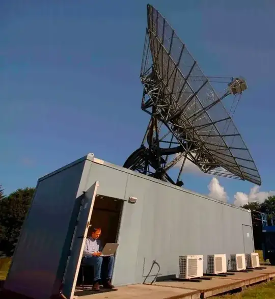

These days with high speed internet, observational astronomy can be done from remote locations. Still I believe from time to time an experimenter might travel to work on-site for particularly challenging or unusual/non-standard observations, where working closely with the instrument support team is necessary.
When astronomers travel to the Atacama Large Millimeter Array or ALMA:
  1. Where do they live?
  2. Where do they work during observing sessions?
Representative photos would be greatly appreciated!
I'm guessing it looks a little different than this:
The WSRT telescope RT5 equipped with the APERTIF prototype - cropped
Source: Cropped from Apertif - the focal-plane array system for the WSRT
Figure 2. The WSRT telescope RT5 equipped with the APERTIF prototype. Shown in the inserts is the Vivaldi array in the lab (top right) and in the focal plane of the telescope (bottom right).

    Well, from my experience, even if you were on-site, you wouldn't actually be able to do anything. To schedule an observation, you submit a document which details what coordinates you wish to observe in which bands at which times. It gets put into a queue which is automatically generated based on when your sources are in the sky, and what other observations are requested. Then the telescope carries out the observations under the guidance of an operator. The operator's job is mostly to make sure nothing goes wrong and to log what the weather is, so that you know what data might be bad. – Phiteros Apr 28 '19 at 05:33
    And after the observations, you wouldn't even be able to use your data because it would still need to be run through the correlator (in the case of an interferometer). When I had a project which involved using the VLBA, our data was available a few weeks after the observations were completed. The hard drives had to be shipped to Socorro to be run through the correlator, then our data was uploaded to the server. – Phiteros Apr 28 '19 at 05:35
