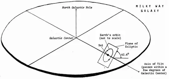

Since the Zodiacal Light lies in the ecliptic plane, the orientation of the Solar system in the Galaxy is something like this:
The Sun moves through the local interstellar gas cloud approximately into the direction of Scorpio with a speed of about 25 km/sec.
Since Scorpio is fairly close to the galactic center (Sagittarius), the Solar System is moving approximately edge-on through the gas cloud as in the NASA diagram. enter image description here
