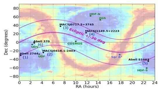

The line defining where the ecliptic plane and the Galactic plane coincide lies (approximately) between the points defined by right ascensions and declinations of 6h +23 and 18h -23.
This can be seen below - the plot is in celestial coordinates with the ecliptic plane marked (thicker solid line) and the Galactic plane clearly visible in the background map of dust extinction.
The second of these coordinates is close to, but not coincident, with the Galactic centre (marked Sgr A*). So the relative tilt is sort of at right angles to the Galactic centre at present.
Of course this will change over tens of millions of years as the solar system orbits the Galaxy.
Edit: Another way of specifying the direction is just to ask where the ecliptic north pole is. It is at RA=18h, Dec=66d 34m, in the constellation of Draco.
A further way of thinking about it is to consider at which points in the sky do the ecliptic and Galactic planes have their maximum angular separation. These are 90 degrees away from the two points I defined above and are almost on the celestial equator at about 0h and 12h.

Although the answer above is spot on, I'm sure, I have a hard time visualizing the geometry. To me, there are two angles to consider (maybe three). I would consider the plane of the solar system to be at "right angles" to the galactic plane if the Earth was always at exactly the same distance from Sgr A. If you draw a line in space between the Earth at it's highest point above the galactic plane and it's lowest (6 months later) I would want to know the angle between that line and the one between the sun and Sgr A. The second angle would be if the line was drawn between the 3 and 9 month points – Jack R. Woods Nov 12 '18 at 16:16
@JackR.Woods You imagine a circle defining the ecliptic plane drawn on a horizontal piece of paper. You then tilt the piece of paper and ask what are the coordinates of the two points that intercept the horizontal plane. These are the points on the diagram above where the ecliptic crosses the galactic plane. One of these points is close to the galactic centre. – ProfRob Nov 12 '18 at 17:04

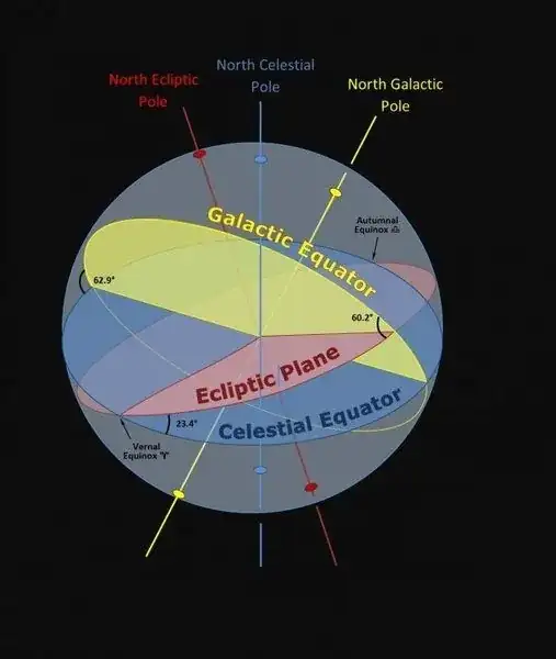

I think that since north ecliptic is l=97 degrees (Lacerta), b=+30 degrees, from earth with 23,5°axis tilt away from center galaxy (celestial sphere is pointing just "only" 3° lower(than ecliptic) toward galaxy disk, b = 27°) it will appear to be Cassiopeia 120°. For stargazing it has more sense consider Celestial sphere be pointing to Cassiopeia (or 27° above (toward galactic north pole) Cassiopeia).

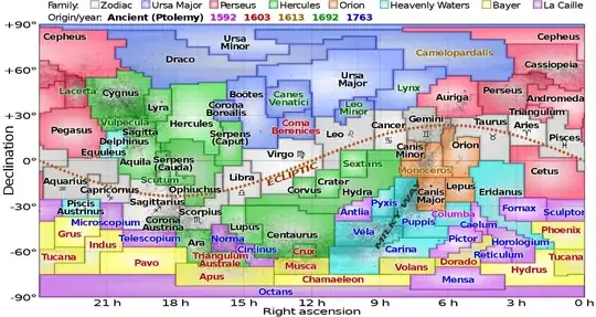

I ve add same pic in bellow as author did, but with stars, which can anyone observe and so can be more familiar with (in appendix it is explained). Milky way is faint there, but you can compare it with the second bellow pic., that shows the constellations in galactic plane surrounding our solar system. Third pic bellow shows Earth position in equinoxes and solstices on its orbit around the sun.

Fourth picture shows galactic, ecliptic plane with celestial equator – shows that ecliptic is 60° (author claimed 63°, but corrected it - anyone can get wrong heh?))
