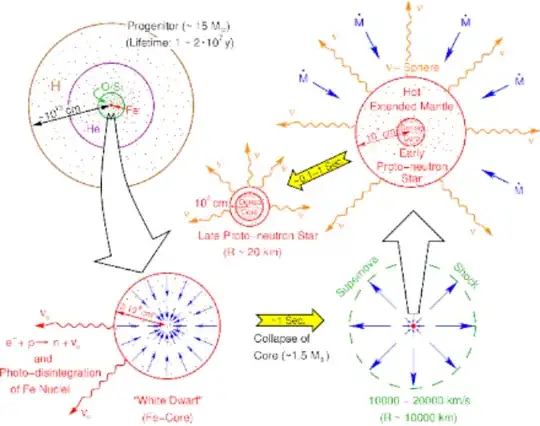

The creation of a proto neutron star is explained in "Neutrino Emission from Supernovae" (Feb 28 2017), by H.-Th. Janka. It has this simple illustration on page 4:
Figure 2 Fig. 2 Evolution of a massive star from the onset of iron-core collapse to a neutron star. The progenitor has developed a typical onion-shell structure with layers of increasingly heavier elements surrounding the iron core at the center (upper left corner). Like a white dwarf star, this iron core (enlarged on the lower left side) is stabilized mostly by the fermion pressure of nearly degenerate electrons. It becomes gravitationally unstable when the rising temperatures begin to allow for partial photo-disintegration of iron-group nuclei to $\alpha$-particles and nucleons. The contraction accelerates to a dynamical collapse by electron captures on bound and free protons, releasing electron neutrinos ($v_e$), which initially escape freely. Only fractions of a second later, the catastrophic in-fall is stopped because nuclear-matter density is reached and a proto-neutron star begins to form. This gives rise to a strong shock wave which travels outward and disrupts the star in a supernova explosion (lower right). The nascent neutron star is initially very extended (enlarged in the upper right corner), and contracts to a more compact object while accreting more matter (visualized by the mass-accretion rate $\dot{M}$) within the first second of its evolution. This phase as well as the subsequent cooling and neutronization of the compact remnant are driven by the emission of neutrinos and antineutrinos of all flavors (indicated by the symbol $v$), which diffuse out from the dense and hot super-nuclear core over tens of seconds. (Figure adapted from Burrows, 1990b)
Notice that the image in the lower right blocks $v$ (neutrinos).

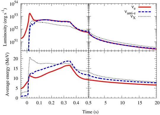

In the study "Observing Supernova Neutrino Light Curves with Super-Kamiokande: Expected Event Number over 10 s" (Aug 22 2019) by Yudai Suwa, Kohsuke Sumiyoshi, Ken'ichirō Nakazato, Yasufumi Takahira, Yusuke Koshio, Masamitsu Mori, and Roger A. Wendell they investigated neutrino properties observable by Super-Kamiokande up until 20 s after the bounce using the database of Nakazato et al. (2013). It includes this text and accompanying graphic:
Page 4:
"While the neutrino-radiation hydrodynamics (RHD) simulations account for the neutrino emission before shock revival, the neutrino light curves from the PNS cooling simulations are reasonable for times after the shock revival. On the basis of these considerations, the neutrino light curves of the early and late phases are interpolated by an exponential function assuming shock revival at either $t_{revive}$ = 100, 200, or 300 ms after bounce. In Figure 1, a typical neutrino light curve obtained by this procedure is displayed."
Page 6:
Figure 1 Figure 1. Neutrino luminosities (top panels) and average energies (bottom panels) as a function of time after bounce for the 13M⊙, Z = 0.02, trevive = 300 ms model.
