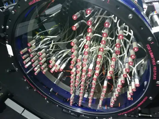

  • Interesting, I wasn't aware of that. This (§2.3, p.3) is what I was thinking of, photo here. It uses hand-threaded fibers. – Alex Hajnal Jan 11 '19 at 08:38

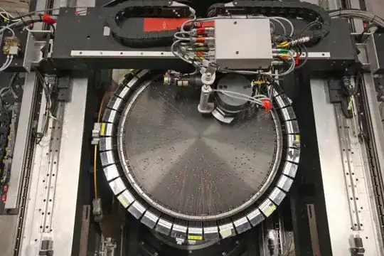

The trick is to put a very large telescope between the object and the fiber, and to use a robot to place hundreds or thousands of fibers at the focal plane, each at the exact location of a galaxy or a star you would like to collect. This way you can line up the other ends of the fibers along a single slit of a spectrometer and study the spectra of thousands or even millions of objects over time without having to point the telescope to each object one-at-a-time.

above: From the astrophysicist Ángel R. López-Sánchez's enjoyable A 2dF night at the Anglo-Australian Telescope
above:: From AAO's The stellar cluster behind Sirius

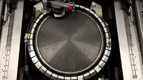

above: GIF from the video (with exciting music) A 2dF night at the Anglo-Australian Telescope

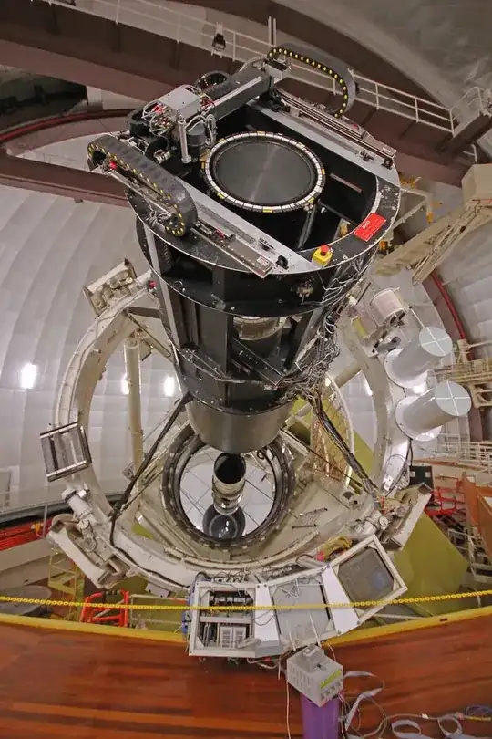

And if you like that robot then consider the "magic fingers" at the focal plane of the Dark Energy Spectroscopic Instrument:
DESI’s focal plane is designed to sit high atop the Mayall Telescope and to carry 5,000 robotic positioners, each holding a fiber-optic cable. Each of these fiber-toting robots is automatically positioned to fix on a preset sequence of individual galaxies and quasars so that the fibers can collect their light. The movements of these positioners must be carefully choreographed to avoid bumping into one another. The roundish focal plane, which measures nearly a meter in diameter, consists of 10 pie-shaped wedges that are fit snugly together. Each wedge holds 500 robotic positioners. The focal plane also contains sensors and light sources called field fiducials that help ensure the positioners are in proper alignment.

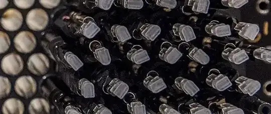

And also these robotic fibers in Australia's TAIPAN instrument at Siding Spring Observatory in North-Western NSW:
