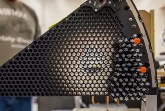

But in simple terms: the circular focal plane is divided into ten wedges (or "petals"). Each wedge holds an array of 500 fibers and their associated robotic positioners. Each set of 500 fibers is collected at the back end and passed outside the telescope to a spectrograph, where the fibers are arrayed into a line to pass their light onto a slit. That is, there are ten separate spectrographs (that's your "bank of spectrographs"), each of which has a single slit with the light from 500 fibers passing into it. (Each spectrograph then has dichroics splitting the light from the slit into three different wavelength regimes and three different cameras, each with a different grating -- 360-555 nm ["blue"], 555-656 nm ["red"], and 656-908 nm ["infrared", though this is still handled by a CCD and it not really what modern astronomers usually call "infrared"]).
The fibers are pretty densely packed into the individual wedges, and so the robotic positioning is done by tweaking/wiggling each fiber a small amount around its default position within a circular hole (you can see glimpses of this in the video), rather than the wholesale movement of individual fibers across the whole focal plane that the 2dF instrument in your video link does.
enter image description here One of the ten focal-plane wedges of DESI, with about 60 (of its eventual 500) fiber-plus-robot-positioner elements inserted.

  • Okay I've got it. It's probably likely that for any given exposure not all 5,000 fibers will have a suitable galaxy within their individual ranges of motion, but that's par for the course with massively parallel architectures. I'll do some further reading now. Thanks! – uhoh Oct 30 '19 at 08:41

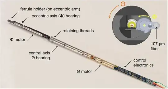

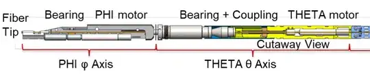

Supplemental to @PeterErwin's answer, some more details on the five thousand "robots".
Each fiber has a circular "patrol area" with a diameter of 12 millimeters, and these are located on a hexagonal array with a pitch (nearest neighbor distance) of 10.3 millimeters.
Motion is implemented with eccentric axis (Θ–Φ) kinematics. Instead of x-y or r-Θ which use two and one degree of linear translation, two rotations are used, in a "shoulder and elbow" configuration.
That the fibers' range of motion overlap improves the probability of finding a target for each fiber, and reduces the dead space (area with no fiber coverage possible) to zero. The robotics systems are aware of the positions of adjacent fibers so collisions are avoided.
See also Dark Energy Spectroscopic Instrument (DESI) Fiber Positioner Production Leitner et al. 2018 in Researchgate and arXiv
Here's a crop of a part of Figure 1 of the arXiv paper linked above, for a detailed view of the robot's (Θ–Φ) kinematics.
From SPIE's Robotic fiber positioners for dark energy instrument
Figure 1. Left: Eccentric axis (Θ–Φ) kinematics. Whenever the Φ arm (R2) is retracted within the dashed circle E, the positioner is guaranteed free rotation about Θ without obstruction from its neighbors. Right: The patrol region (the area within which every point can be reached by the robot) coverage extends beyond the pitch. This assures complete coverage but requires implementation of collision avoidance algorithms in the move control software. R1, R2: Kinematic lengths of the Θ and Φ arms. xc, yc: Center of robot. x, y: Position of fiber. Θo, Φo: Home positions. 1×, 2×: Coverage by a single positioner and two positioners, respectively.
Figure 2. DESI (Dark Energy Spectroscopic Instrument) 10.4mm pitch Θ−Φ fiber positioner. The centers of the two axes are indicated on the insert (top right).
