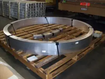

LVIR
Launch Vehicle Interface Ring (LVIR) Forgings (2) delivered
